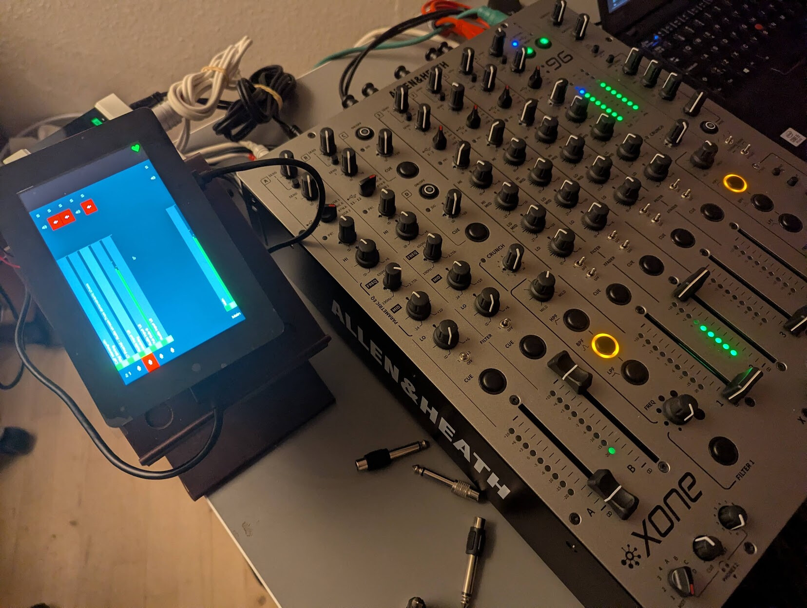

"Simple" DJ multi effects unit?
Got an official Raspberry Pi Touch Display 2.
Have to figure out how to rotate it :smiley:
DISPLAY=:0 xrandr --output DSI-2 --rotate left works. But when I do that while zynthian is running it looks all wrong and the touchscreen is off.
I went into the display settings of the webconfig and added dtoverlay=rpi-display,speed=32000000,rotate=90 but that did not do anything.
Anyhow, for now just added a dub delay, just wet signal, and it seems to work.
For each individual channel, I can send the track to zynthian, and get just the effect on a return channel.

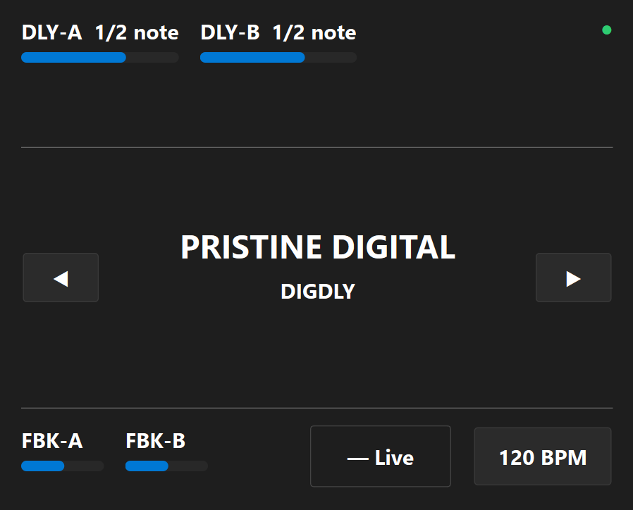

The project was a bit on hold because I figured out how to send sysex messages to my Eventide H9. And currently building my own UI for it:
With live BPM detection.

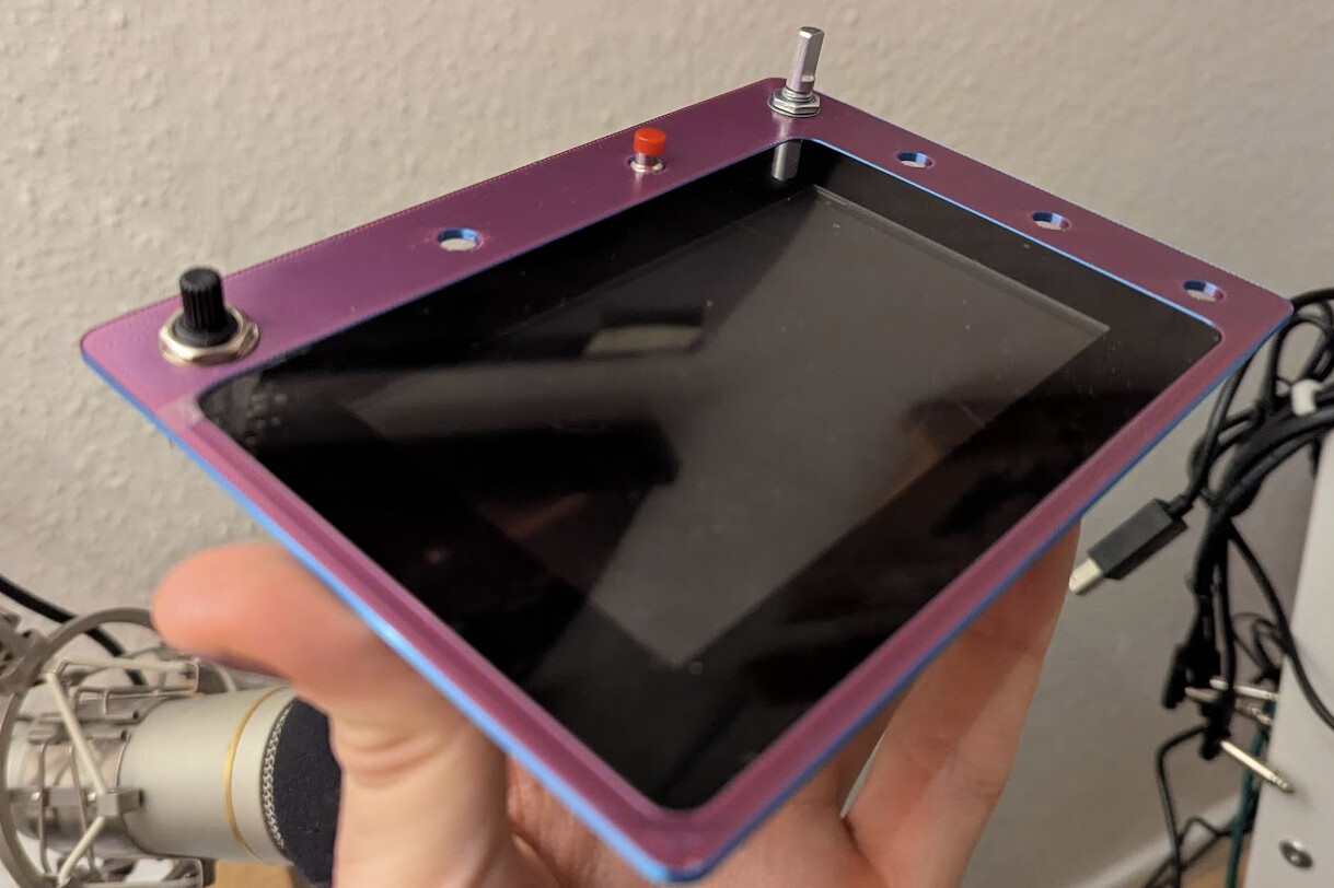

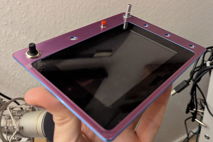

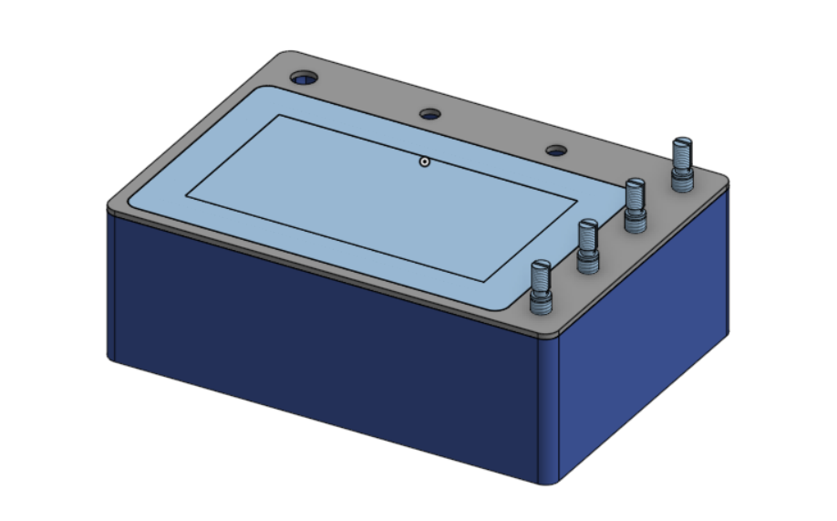

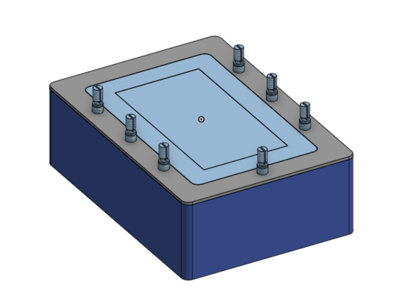

Could for the life of me not find a CAD of the 5” screen anywhere. Modeled it my self and just a basic case with space for some rotary encoders that I want to connect to the pi.
The idea is to use this both for zynthian and later on my own controller software. Just to mess around.
Now I’m wondering if I can make a UI inside of zynthian that can control the Eventide H9. It’s “just” sending and receiving sysex messages.
You want an hear how I use the dub delay from zynthian with my DJ mixer?
If you are considering building a zynthian, then you may wish to put 4 encoders on the right side, which aligns with zynthian’s hardware / software controllers. We have contol views that have 4 controllers. In older version (V4 and before) these were two on the left and two on the right. Since V5 (with a bigger screen) it is 4 on the right.
