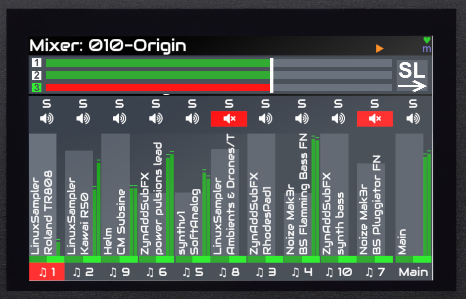

I’ve been playing with it a bit, and my biggest problem is actually having to go back to the looper screen to operate it. My typical workflow with a loop pedal is to record a loop on one instrument, and then add layers/tracks on other instruments. So, as I’m changing instruments with zs3s, I’m constantly going back to the mixer view and have to get back to sooperlooper from there.
For my use personal use case, I would love to see a reduced SL GUI shown on the mixer screen so that instrument changes, loop activation, selection, position and status can all be seen in one place. I personally need to see that a loop is playing/recording/overdubbing, and approximately where I am in the loop. It wouldn’t need to have a lot of controls.
Something like this maybe?
Tracks 1 and 2 are playing, track 3 is recording. I would envision changing the active track with CC changes, and the single pedal functionality would work for the selected track. The SL button on the right would take you to the main sooperlooper screen to make settings changes. There would probably be some setting there that would enable or disable this view on the mixer screen.
If I had this, I could sell my looper and buy more pizza!
Just my 2 cents.

This is an interesting idea. Your mockup looks good but how well would this scale, e.g. what happens if there is one or 6 loops? We may also want to see other things in the mixer view. (We need some flood gates to avoid being inundated with requests to show this, that, etc…) We are getting into the realm of expandable frames but, maybe we could consider some screen space available to show custom widgets in mixer view (similar to how we do the custom widgets in the control view). This might best be considered in the discussion on UI changes where we have discussed showing a more graphical chain layout.

@riban I will add to the UI/UX thread after I experiment more if it still seems like a good idea.
