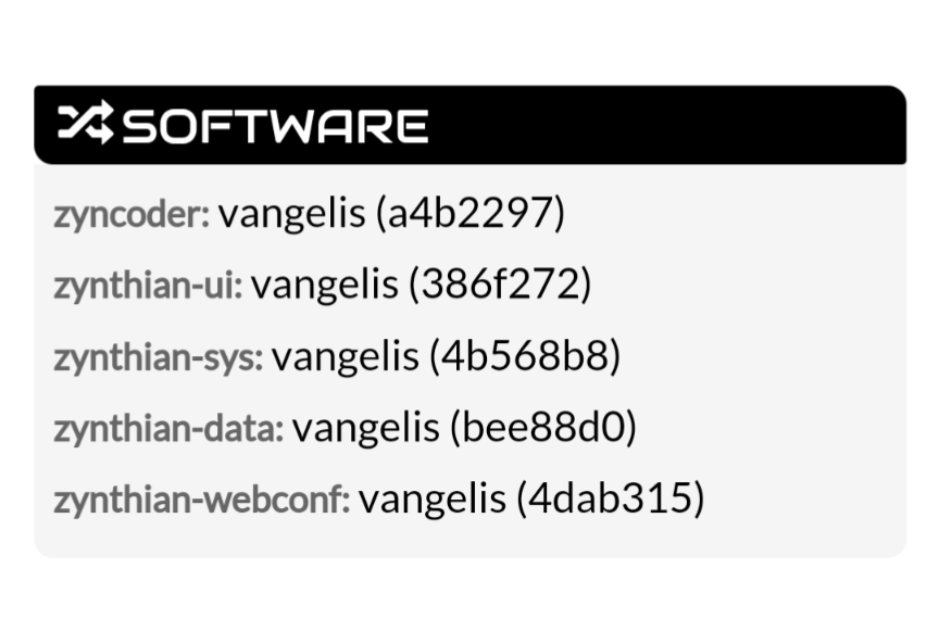

Not getting an update, maybe I already got it earlier. Here are my versions:
Want to make sure I’ve got the latest before I try 3 tracks again…
That is the current version.

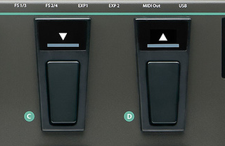

I’m now in the process of learning the Nektar Pacer possibilities, and i think i would get some very easy to setup and operating functionality if the prev/next button was restored. Can we have both?
I have a setup now that kinda works for shifting up and down through the loops, but i think sending ccxx 0 on one pedal and ccxx 127 on another would be the way to go with a multi pedal board?
And it would look like this:
which looks quite understanable + i mean you would not forget which pedal to push…

Yes! If you can send CC value 0 from one switch without sending any other value, and CC value 127 from another switch without sending any other value, and can send the same CC on both pedals, then you should be able to bind them to the loop selection control in relative mode 4. One switch will nudge it down whilst the other switch will nudge it up. It is (pretty much) the same behaviour that we had on the prev/next controller.

Nektar Pacer can do that.

Is that with a fully updated testing (vangelis)?
I must admit - i updated yeasterday, but there is a new one. I’ll do it now!

What is your zynthian-ui hash?
