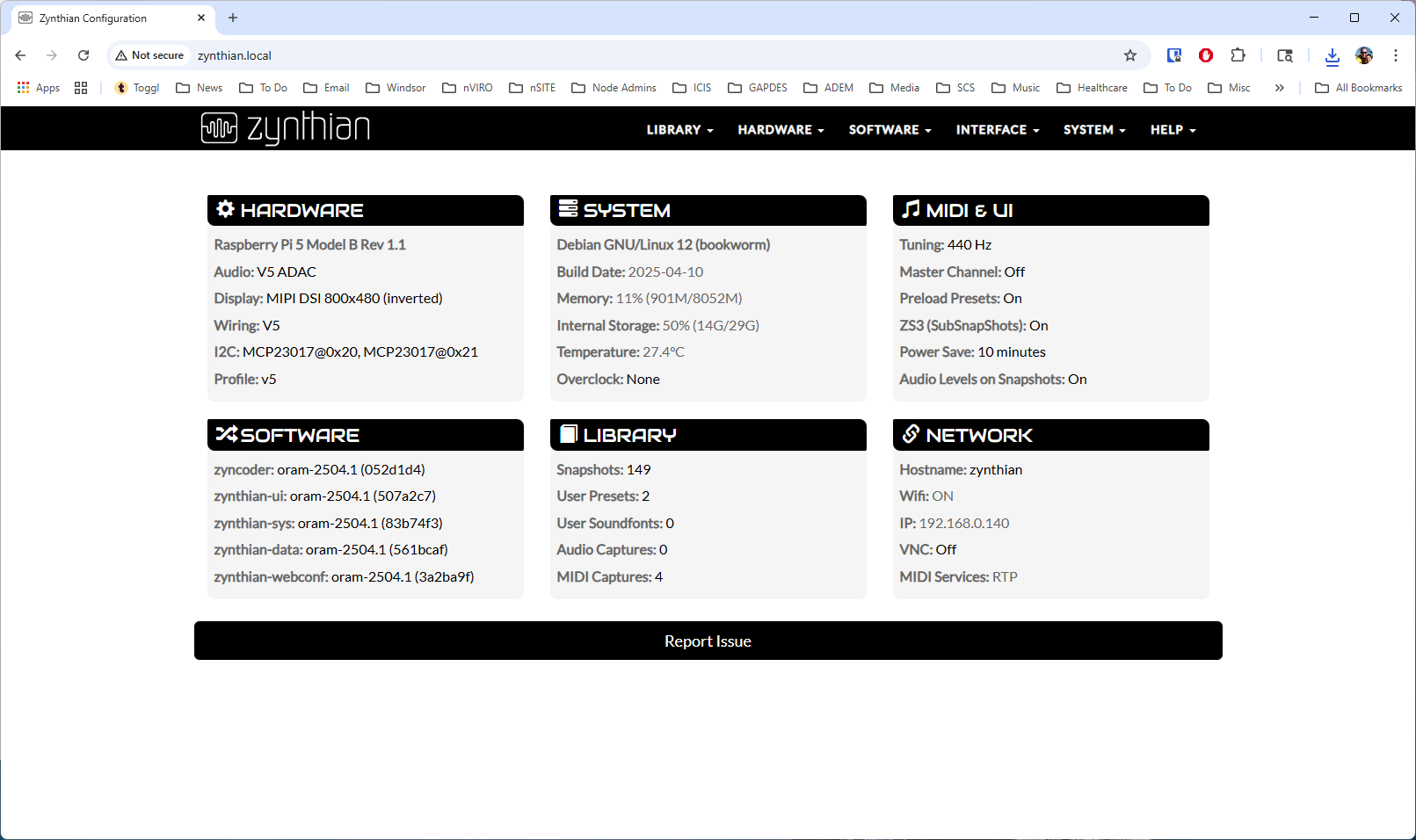

Please give us a screenshot of the “dashboard” from webconf.

Per your request I have also included a snapshot of my webconf screen:
Please let me know if this helps to troubleshoot the issue. I wonder if the insufficient clearing between selecting different snapshots is also causing the issues with the inconsistent volume levels.
