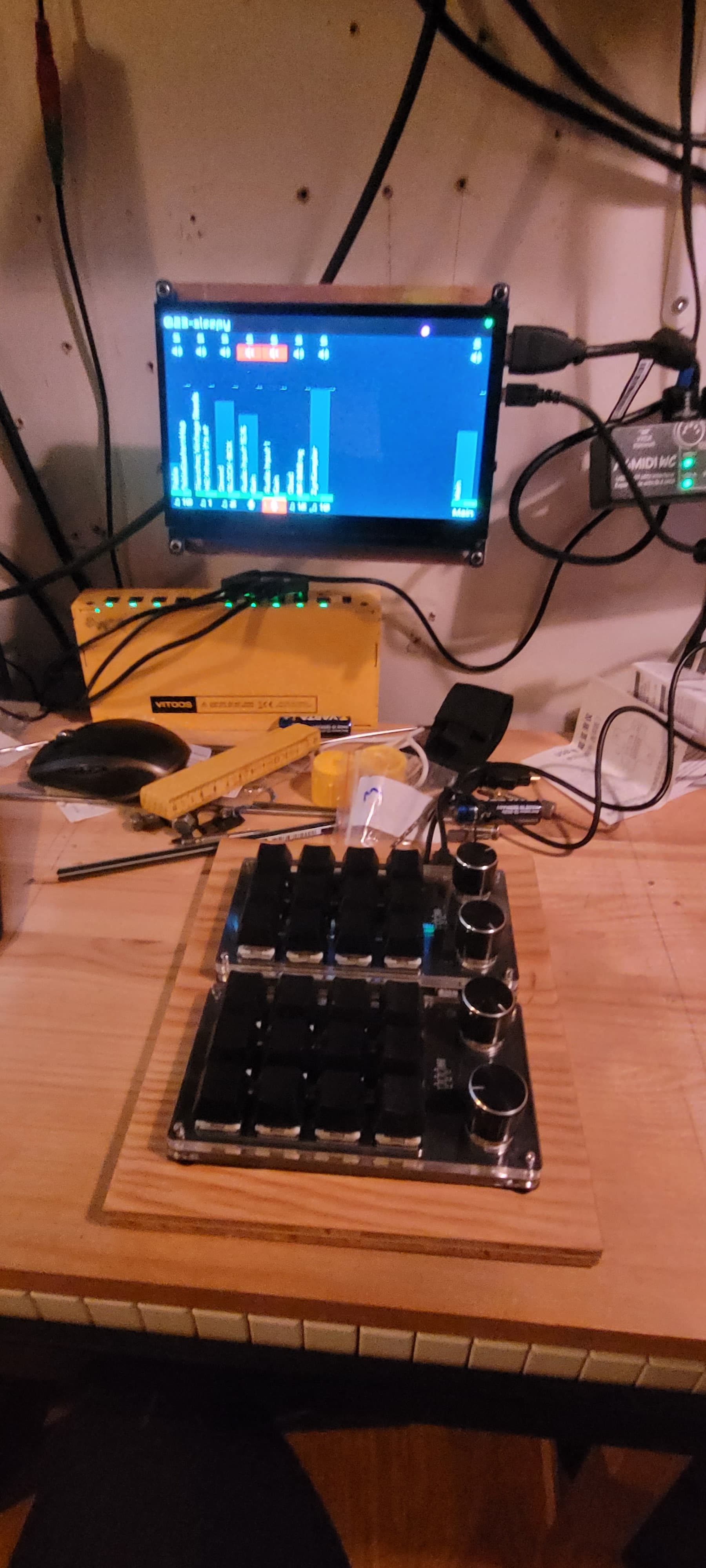

@Lanfranco thx a lot, but i allready have a plan for that in a way. I was just on my way to my workshop to do something similar with a piece of plywood and a router. I do drawing in OnShape.
I have access to a 3D printer, but i never learned to use it. But it is somewhere down the road i guess…

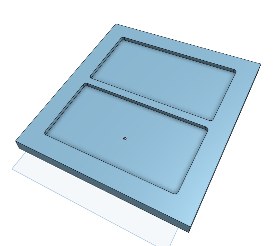

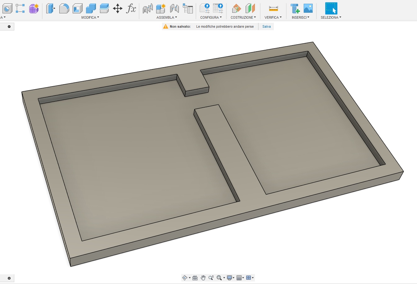

I’m not sure that we are talking about the same thing, i need a tray like this:
to make my two keypads into one!

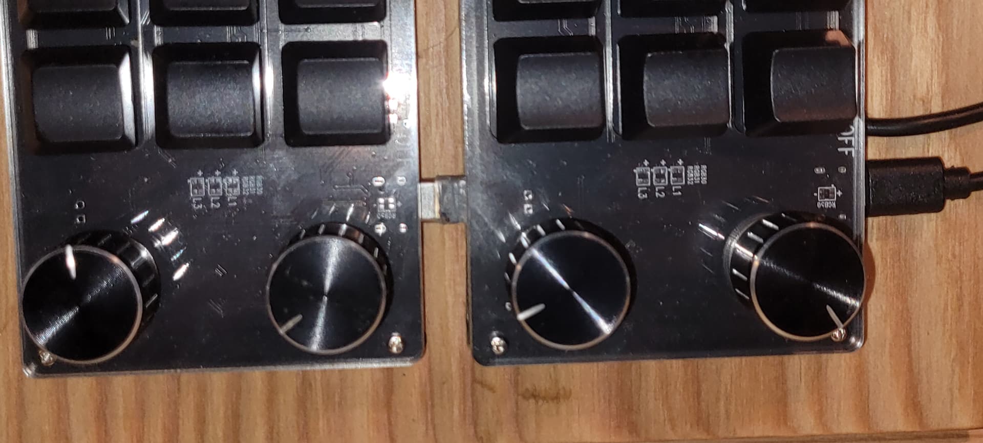

Yes, I understood, but you will also need space for the connector in between the two controllers… about like this.

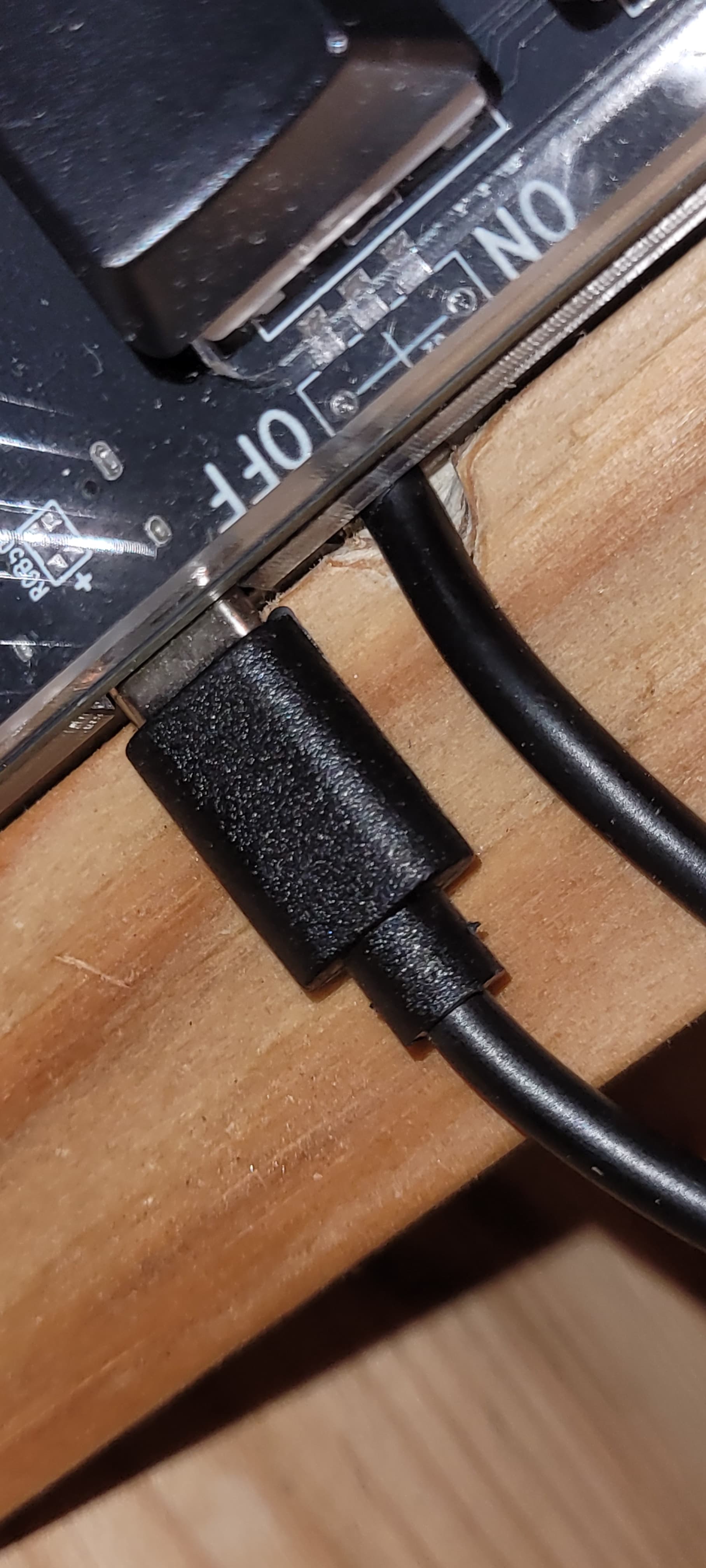

EDIT: well i carved away some wood with a knife and mounted the whole thing, it is not beautiful (seldom it is) but it works…
I embedded the keypads at 4mm depth so it was not necessary to route for the plug
It’s more like a base, a spacer and the top, and it is only the top that has any functionality. The USB connector sits below the top (there is made room for it in the spacer), but the rubber on the USB plug extends beyond the spacer, which is why i removed it (the rubber).

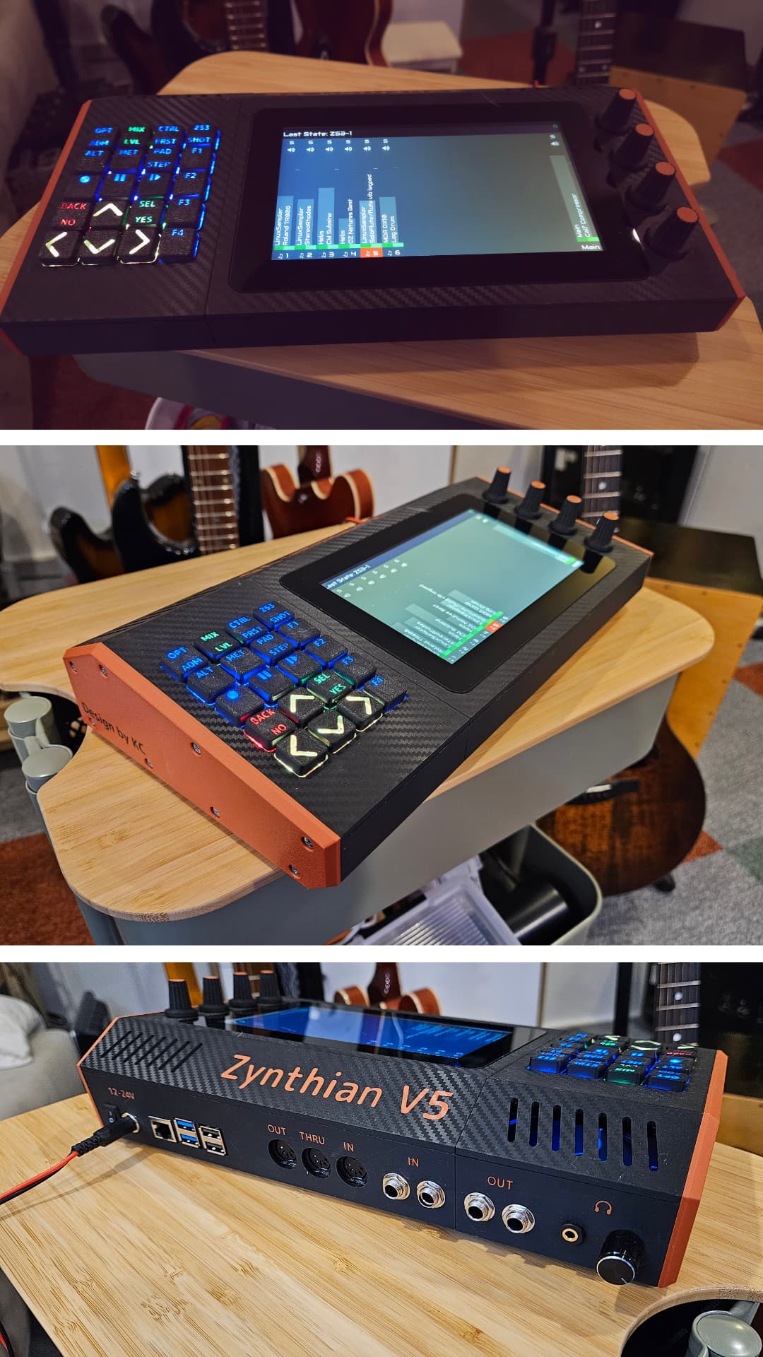

Inspired by Synthibox, a RaspberryPi case for the Zynthian Project, made in OpenSCAD by Low-Z | Download free STL model | Printables.com

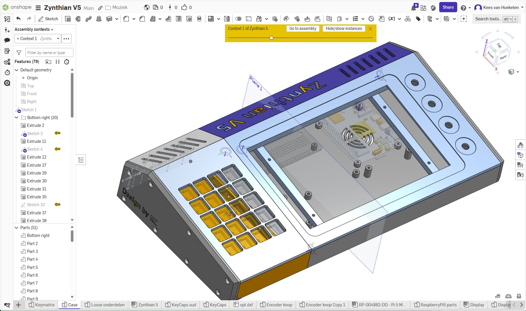

Designed from scratch because I can’t stand openscad :wink:
to machine
Runs a Pi5 with SSD, Hifiberry board, has DIN midi and a separate headphoneamp :slight_smile:
Want to build one yourself: Onshape
Cheers,
Kees
This is astounding @Keeze101: terrific design and lovely composition of profiles and colours. Kudos on this remarkable custom Zynth, one of the most beautiful success cases in my opinion.

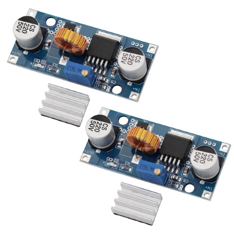

What power convertor did you use?

For now just a regular stepdown converter with a 15v 2.5A psu. My gripe is it gets a bit toasty and I am testing some other options. When in use the 15v line draws about 800-900 mA (2.5/3 A at 5v).
