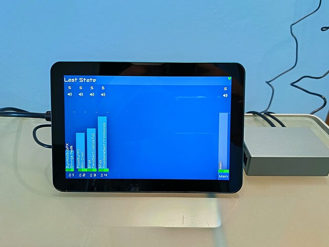

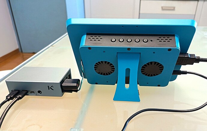

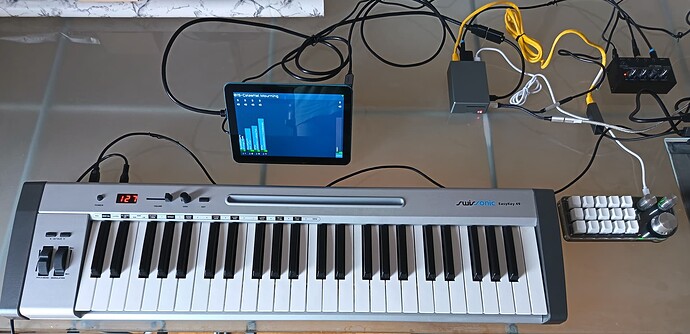

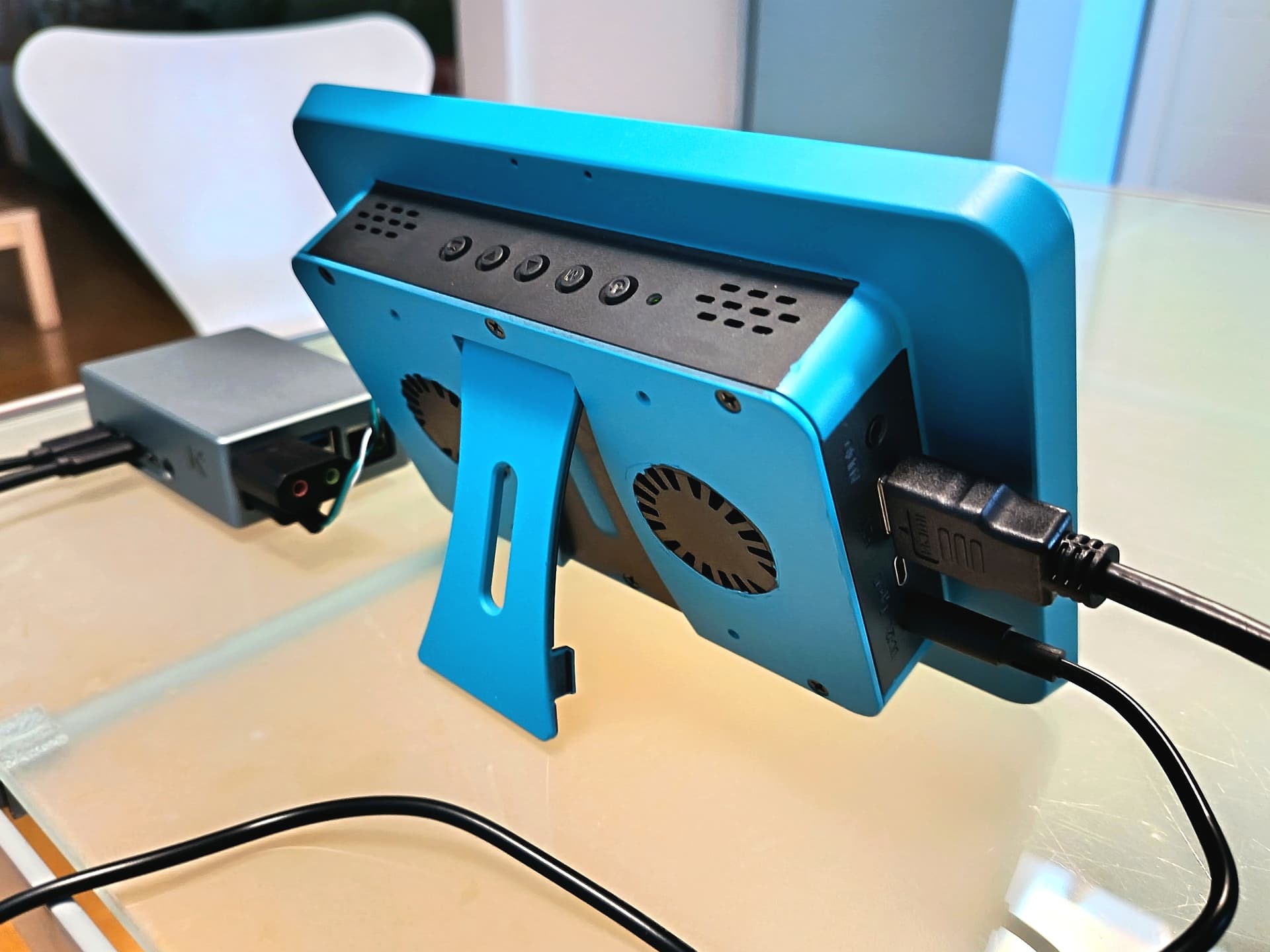

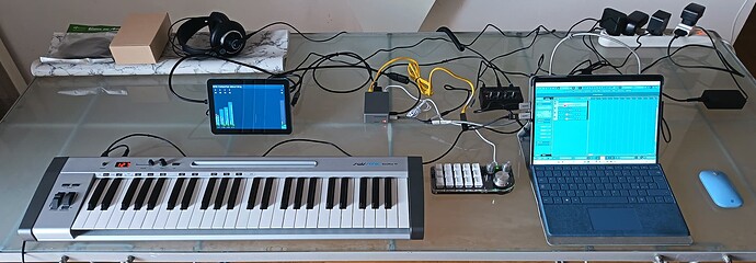

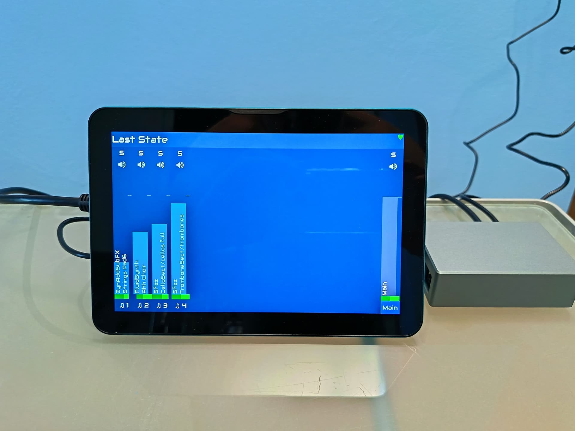

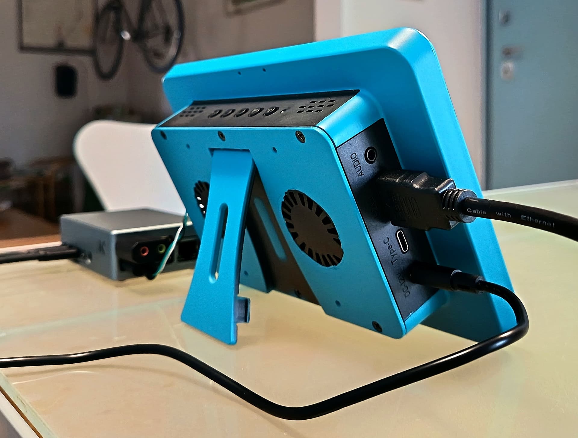

Well, now it is time to present my visually pleasing (at least so I think) latest Zynthian contraption (I do not dare qualifying it with the blazoned title Success Case). It was essentially meant to recycle a spare Pi4, leftover from the V5 > V 5.1 update.
I ordered from AliExpress an apparently apt Unew 8” touch display with Raspi case. Long story short: the manifacturing of the innards, advertised as capable of holding safely and conveniently the computer board, was manifestly poor, with PSU and micro-HDMI adapters extremely prone to rupture. Moreover, the built-in active cooler was unbearably noisy. Thus, I ended up enclosing the Pi4 in a lovely machined grey aluminium KKSB case from Amazon.
The touchscreen was available from the factory only in a boring plain black ABS finish, which I unreservedly disliked straight away. After some deep research, I discovered that the English brand Army Painter provides an extensive palette of spray colours with embedded primer, for model-making and fantasy figurines in plastic, of which I rather predictably chose a beautiful Hydra Turquoise.
The audio compartment was implemented with a surprisingly well-sounding Sabrent USB-A micro interface (just mini-TRS stereo in and out, but enough for the purpose), and the Midi feed was done with a Y USB-C cable (data+power), through which my laptop recognised the Zynth as an available Midi out from Cubase, once I did the trick of sending MIDI data from a powered USB-C hub.
For the tactile interface, I got another model of the sturdy Romoral store keypads with potentiometers, from AliExpress: in this case a 15 keys + 3 pots variant. All the UX configuration was made through key-binding in webconf, and obviously I used on the UI one of my custom Zynthian colour profiles.
I cannot enjoy on this build the powerful and Pi-5 restricted DSP 56300 releases (which I adore, as many of you know), since at the core of this mini-system there is a Raspi4 with 8 GB and ordinary mSD storage.
Still, all in all it fares very well: the good, proven and time-honored Z plugins are there, it sounds clear and crisp despite the humble audio equipment, and the thermal dissipation through the full-metal enclosure is excellent.

It does look stunning Aethermind what you have built here, even if it “only” runs the rPI4 :slight_smile: Love the bluish colour of the casing which looks very nice. Also, i guess any heat-dissipation issues that you theoretically might have would be non-existent. The separate keypad is genious. In my mind, that is the ultimate controller. Great work :right_facing_fist:

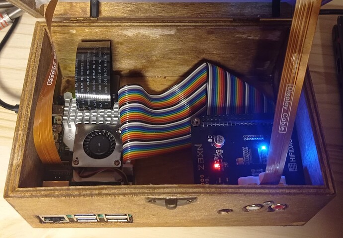

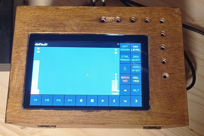

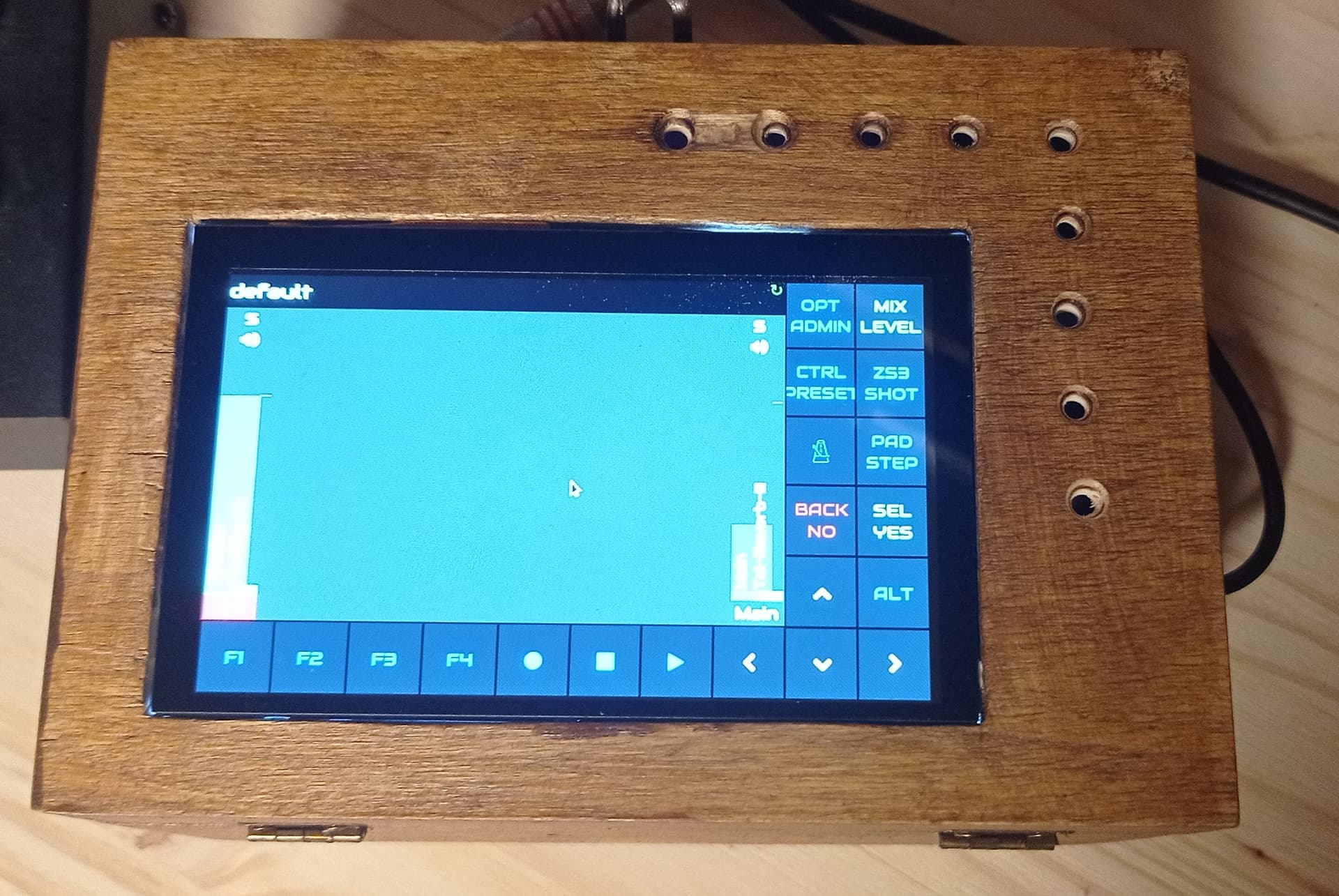

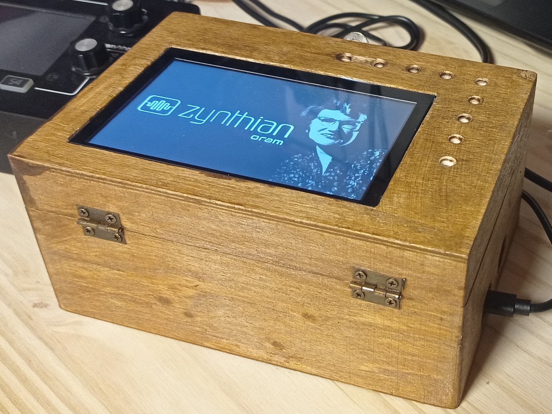

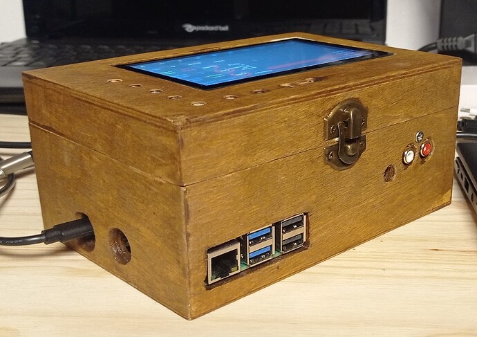

My minimal, home made, WoodenZynthianPi5

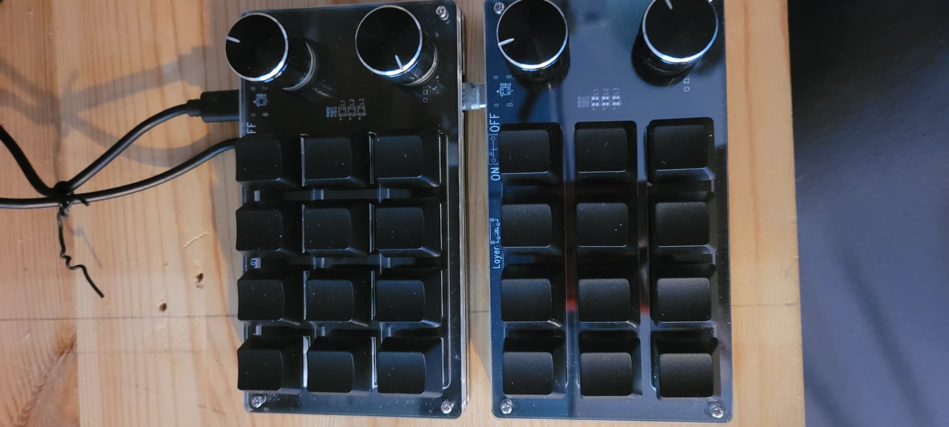

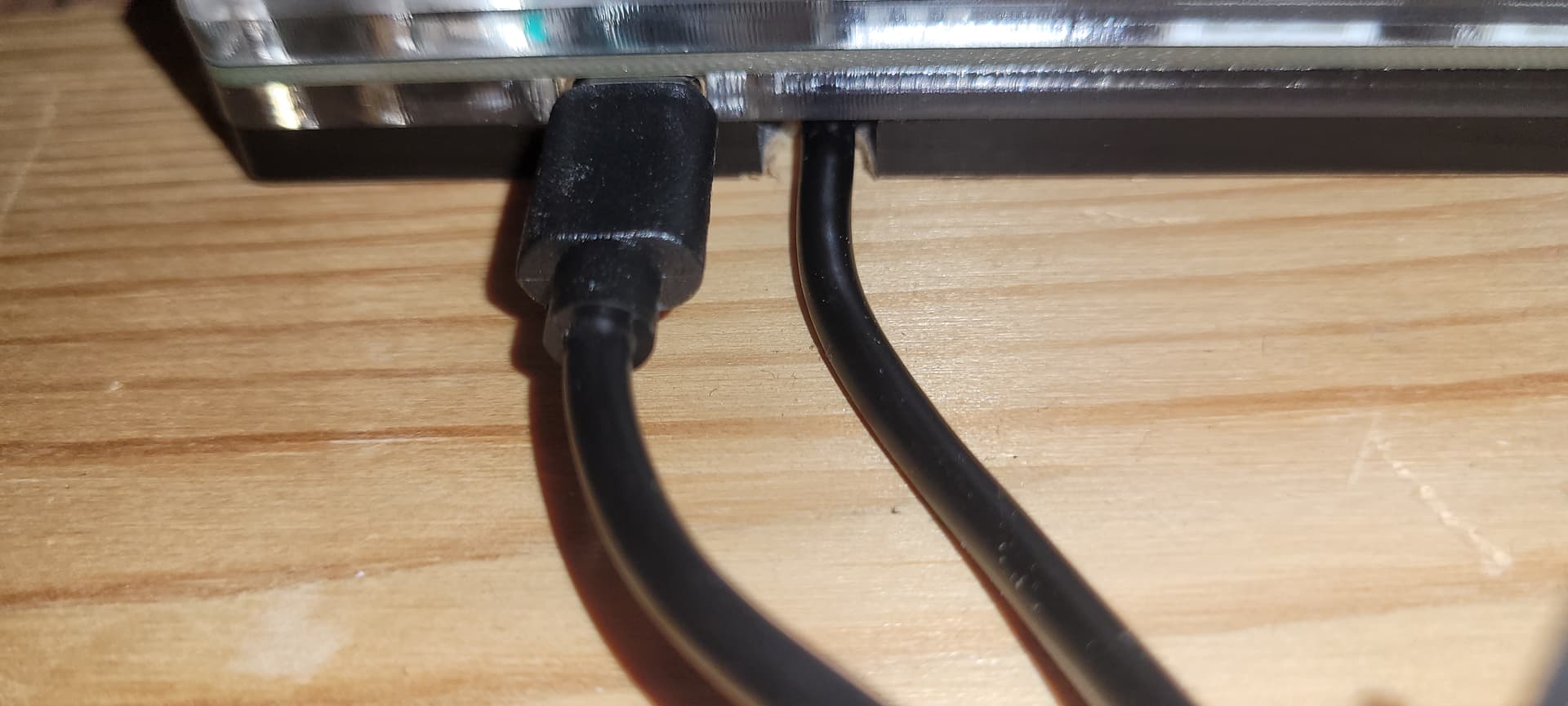

Well i got the two Romoral keypads (link) - the ones with 12 keys and no BT or LED.

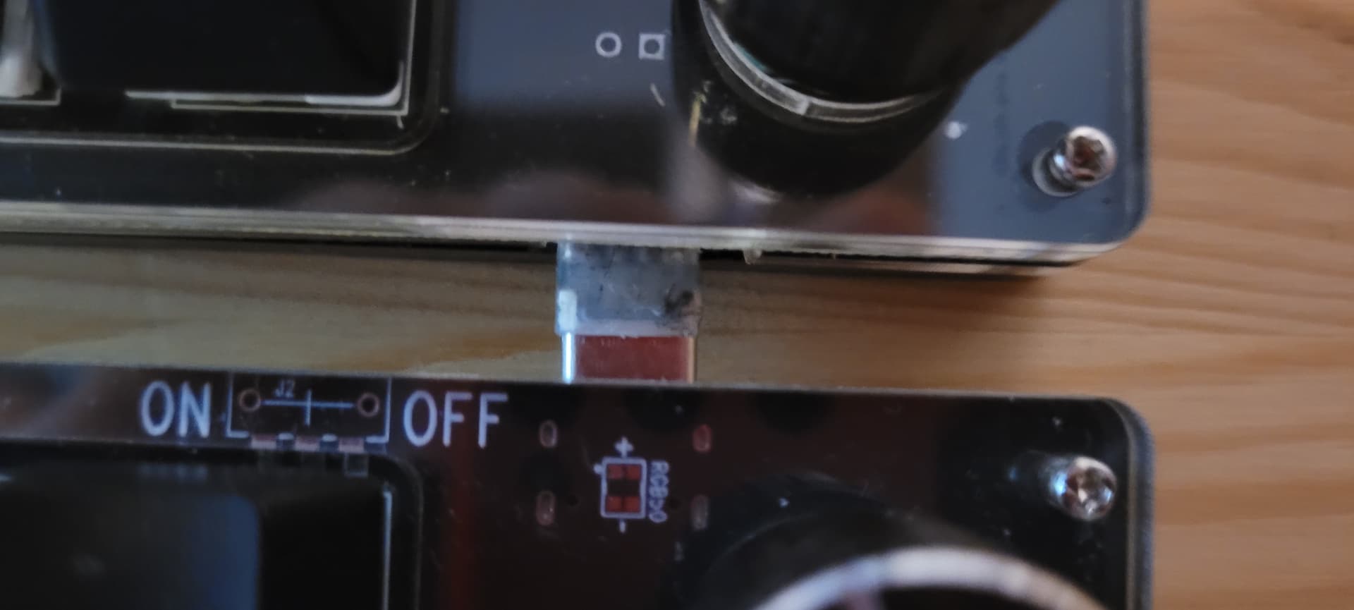

By removing som material from the base of the upper keypad and the rubber around the USB C plug i could fit them together like this:
Nect step: Route cavity for both keypads in a piece of plywood, outsource a “cable-spiral” and spiral the two cables inside. The longer must be dubled back a little inside the spiral so both USB A plugs are equidistant from the keypads. Off course i would maybe have preferred to do something like Toff’s done earlier in this thread, but i have plenty of USB ports i think.
