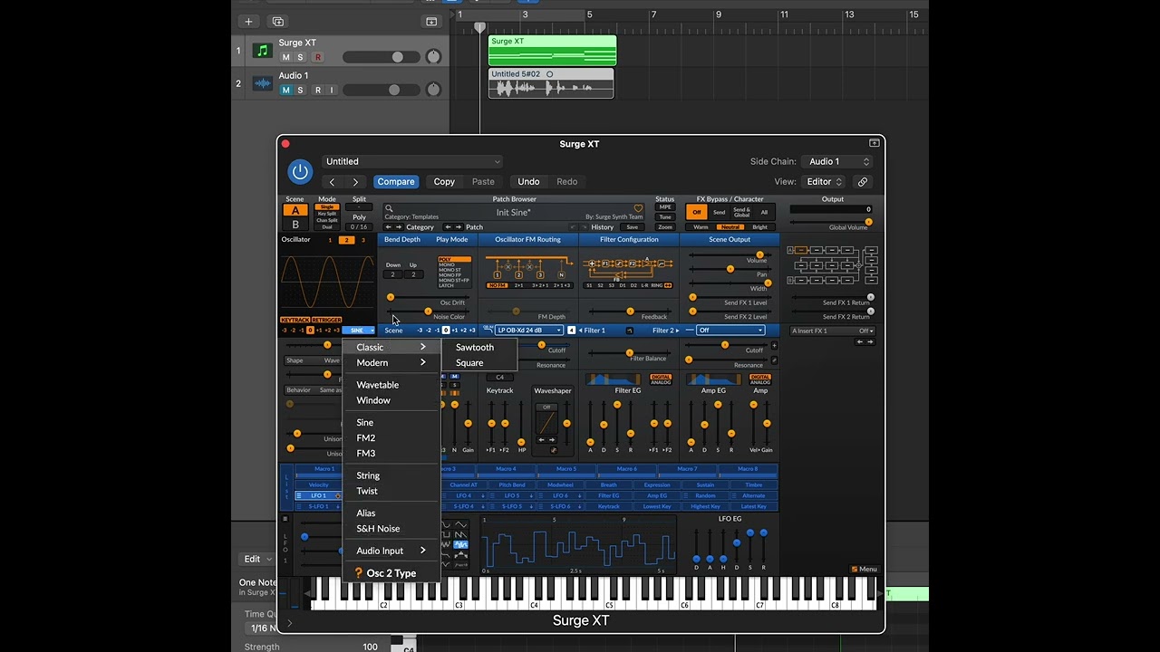

Surge also has an input and can take side chain inputs allowing you to mix any audio in with the entire synth effect filter and oscillator chain in a variety of ways. This may be of interest to your community.
And as well as surge, there’s a surge effects bank which just makes each of our effects. Should build as an LV2 also and may be of use? You could at least get an implementation of clouds running at zero cost other than including the plugin.
I see two audio inputs. Are these used as two seperate side chain inputs or a single stereo input?
I have added Surge XT sidechain input routing to Zynthian. Update Oram and enjoy.
That’s a stereo input
Using it you can do things like set an oscillator to audio input or use the built in vocoder
Here’s an example of using the vocoder in logic
I have currently implemented the side-chain inputs as dual mono, i.e. you can route to either or both individually. I can’t figure out if it makes any difference routing to one or both. I was able to hear the vocoder working on Zynthian but didn’t have a good configuration to hear it in its best quality - just enough to prove it is working.
