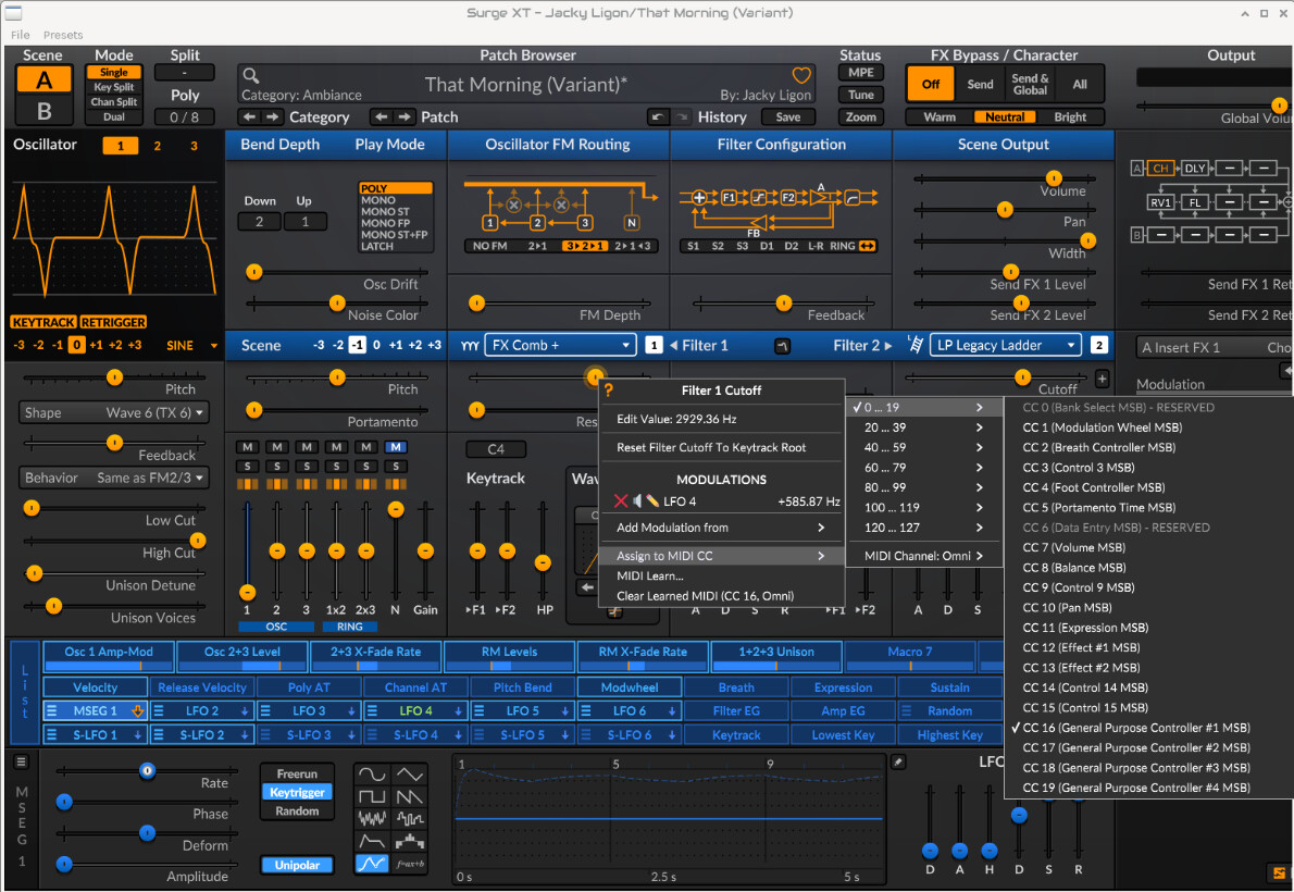

I think that Surge XT is the best and more complex synth we have in Zynthian (togheter with Odin 2) but it’s a pity that there’s lack of usable controls. I opened the VNC interface, wich is great, and i noticed that i can assign midi CC and also do midi learn for almost everything. So i tried to assign basic stuff like cutoff, resonance, envelopes… with my MPK mini plus but it’s impossible to complete the task. Midi learn won’t respond running from Zynthian to Windows pc, and whern i assign a midi CC manually and save the patch i can’t load it from the Zynthian interface. I wasn’t even able to find the exact position of the single patches in the directories so it’s impossible to overwrite manually.
Any suggestion for a method to have some basic mapping to a hardware control?
In vangelis (testing) branch we have a new version of the LV2 plugin host which exposes the parameters of Surge-XT. There are a lot of them so it may be challenging to find and map what you want but it should be possible. Then you can save and recall presets within zynthian’s preset management mechanism.
Hi Riban, i’m using the Vangelis branch but i can’t see the parameters. Am i doing something wrong?
