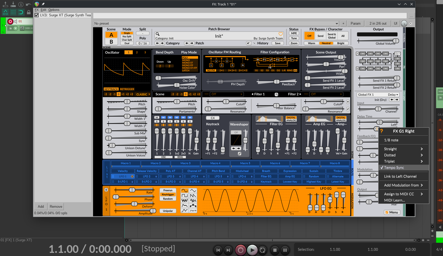

Tried on the desktop PC. Opensuse/Reaper/Surge XT 1.3.4 LV1 - the internal delay effect is synchronized
I just tried in Ardour and could not get sync to work. @spurkopf can you show steps to make this work in Reaper?
The effects are on the right-hand side. DLY is selected as the global effect. The pop-up appears when you right-click on the Delay Time. Tempo Sync is the default setting.
Yep! I go that but wanted a full example of how to show the tempo change happening… but I have been able to do this in reaper so confirm that Reaper can set the tempo of Surge XT delay. It is not yet clear what mechanism is being used. We use JACK transport and its tempo but that needs to be translated to the LV2 which has its own transport mechanism. I’m sure we have our tempo changing other LV2 plugins so this looks like an oddity with Surge-XT but it seems to also be an issue with Ardour, so maybe Reaper does something different???
