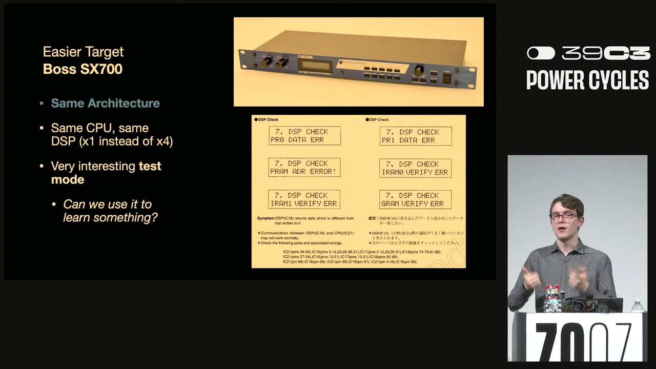

For even more amazement, check out this video where Giulio Zausa (giulioz, who is also the man behind VirtualJV) talks about how The Usual Suspects reverse engineered the DSPs used in the JP-8000.
