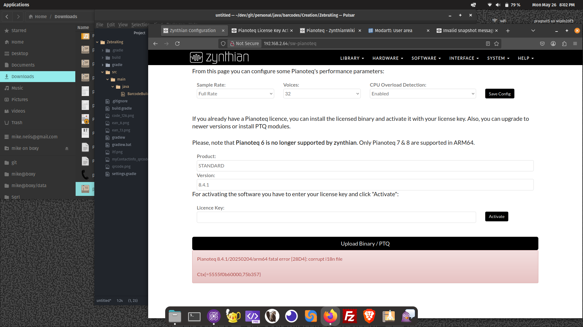

I just purchased Pianoteq. I installed it on my laptop and it is working fine. I followed the directions here: Pianoteq - ZynthianWiki to install it on my Zynthian. I accidentally tried to upload the unencrypted files first, but then realized I was supposed to upload the whole 7zip archive.

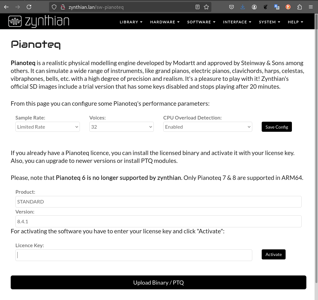

After doing this, the Zynthian web UI showed the correct edition of Pianoteq. I then entered the license key and now the web UI shows what is in the attached image. If I try to add a Pianoteq instrument, I see the following error on the Zynthian screen:
ERROR CUIA zynswitch: (3, 'S')
Any ideas?

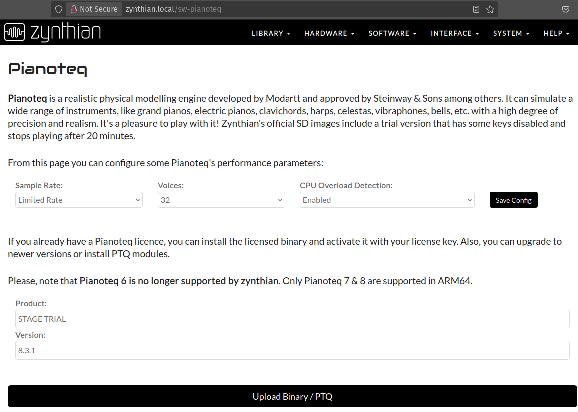

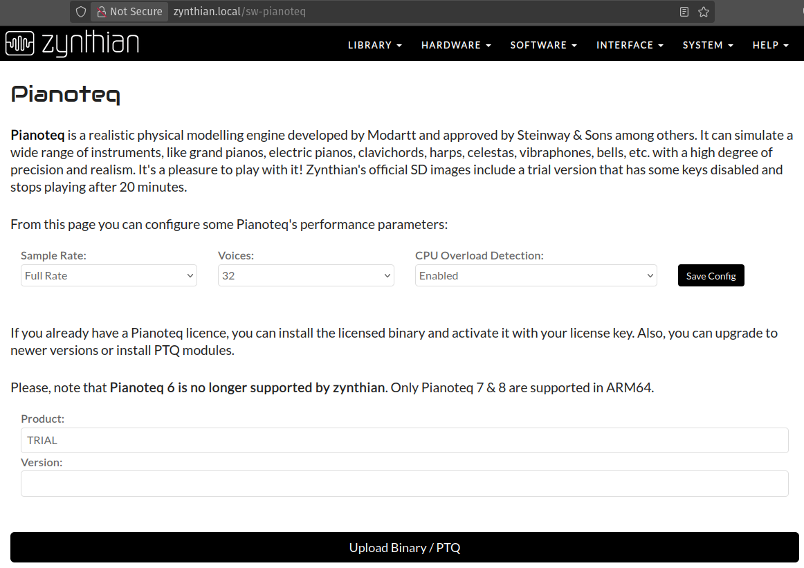

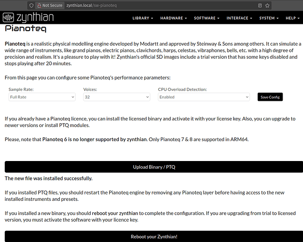

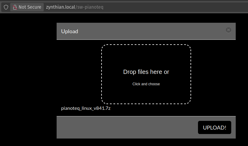

So I am still stuck here. I think there must be a bug. Here is what I am doing (note I have already purchased Pianoteq and am running it on my laptop):
  • Freshly create a new Zynthian SD Card.
  • Log into the Zynthian webconsole
  • Go to the Software | Pianoteq page (see image 1-ZynthianPianoteq-InitialScreen.png)

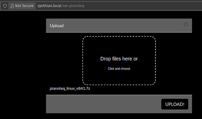

  • Upload the Pianoteq image. You can see I am uploading the whole linux 7zip archive. (see image 2-ZynthianPianoteq-UploadScreen.png)
  • Press the “Upload” button

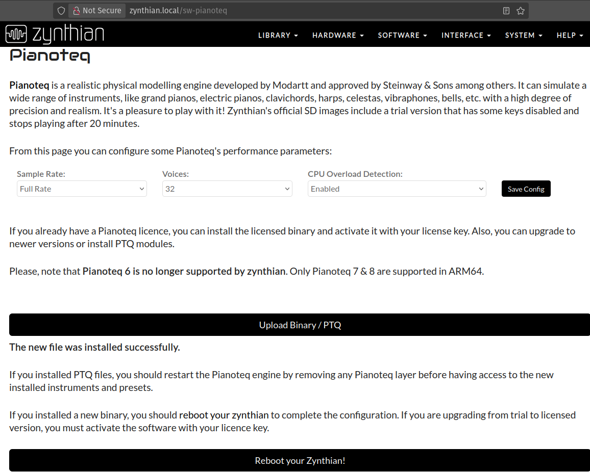

  • Wait for upload to complete (see image 3-ZynthianPianoteq-UploadCompleteScreen.png)
  • Press the “Reboot your Zynthian” button and the confirm button on the next page
  • Wait for reboot
  • Go back to the Software | Pianoteq page (see 4-ZynthianPianoteq-AfterRebootScreen.png)
You can see that the license key entry screen is not available. It just shows “TRIAL” under product.
Has anyone tried doing this same thing from a fresh SD Card? I am being careful to follow all the steps. I have read other threads and I am not making the same mistakes (for example, some people were not pressing the red “Upload” button on the upload screen).
I ssh-ed into the Zynthian as well. I did notice that the /zynthian/zynthian-sys/scripts/recipes/install_pianoteq_binary.sh script seems to have renamed the old trail install of pianoteq (the one that came with the original image) and seems to have installed my version. However, Pianoteq is gone from the Zynthian UI (running on the device) when I try to add it as a instrument. After this process, the “Piano” section of the interface only shows:

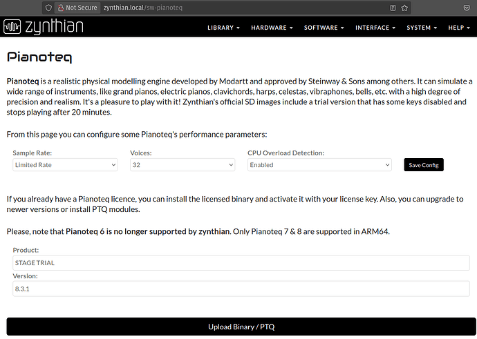

I just tested with a fresh burned Oram-stable-2505. It worked flawlessly at first try:
Perhaps you could try to download the latest stable image that is out from today :wink:
