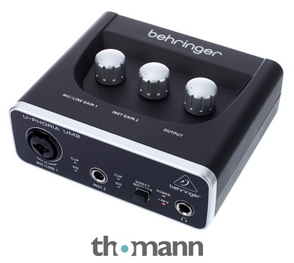

It also depends if you want to have an entirely analogue input to the zynthian or might prefer an USB audio device…
is the sort of thing This will appear as audio devices in the zynthin and provide an audio output. but is important you get a device that does in and out as the zynthian is not able to deal with two separate audio ins & outs that don’t have a common clock signal.
It can be done but it chews up a lot of processing power doing the required rate conversion and matchjing.
