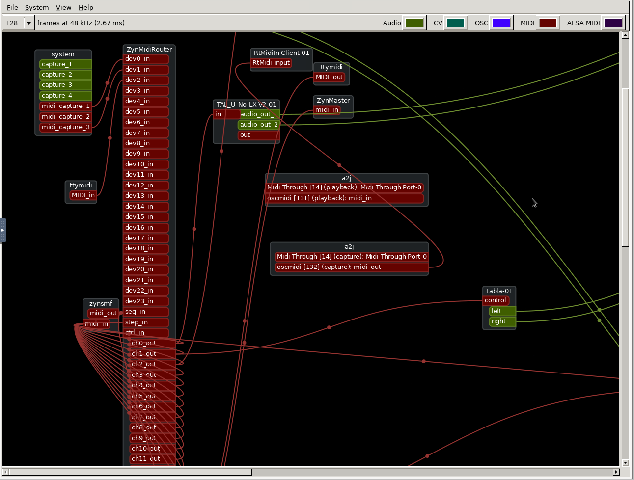

Hi, I’ve been experimenting with running Open Stage Control directly on Zynthian (not externally on a laptop). Surprisingly, it’s quite doable, but you need to pay attention to a few details (PATH / ports / MIDI backend).
1) Installing Node.js (arm64 tarball) into /opt/nodejs
I downloaded an ARM64 build of Node.js and installed it “manually” into /opt/nodejs:
cd /zynthian/zynthian-my-data/tmp
tar -xJf node-v22.11.0-linux-arm64.tar.xz
sudo mkdir -p /opt/nodejs
sudo mv node-v22.11.0-linux-arm64/* /opt/nodejs/
# (for interactive shell) add PATH to .bashrc
echo 'export PATH=/opt/nodejs/bin:$PATH' >> ~/.bashrc
source ~/.bashrc
node --version
After that, Node works normally from the command line.
2) Putting Open Stage Control into zynthian-my-data
I put everything here:
/zynthian/zynthian-my-data/openstagecontrol/
  app/        # O-S-C (node build)
  sessions/   # my sessions + scripts
Specifically these session files:
  • /zynthian/zynthian-my-data/openstagecontrol/sessions/zynthian.json
  • /zynthian/zynthian-my-data/openstagecontrol/sessions/main.js
3) Running it (example command)
I’m using headless mode (-n) and sending OSC to Zynthian CUIA on localhost.
/opt/nodejs/bin/node /zynthian/zynthian-my-data/openstagecontrol/app/ \
  -s 127.0.0.1:1370 \
  -l /zynthian/zynthian-my-data/openstagecontrol/sessions/zynthian.json \
  -c /zynthian/zynthian-my-data/openstagecontrol/sessions/main.js \
  --port 8088 \
  -m sysex oscmidi:virtual \
  -n
4) systemd service (so it starts automatically)
I created this unit:
/etc/systemd/system/openstagecontrol.service
[Unit]
Description=Open Stage Control (headless) for Zynthian
After=network-online.target
Wants=network-online.target
[Service]
Type=simple
User=zynthian
Group=audio
WorkingDirectory=/zynthian/zynthian-my-data/openstagecontrol
# systemd doesn't read .bashrc, so set PATH explicitly:
Environment="PATH=/opt/nodejs/bin:/usr/local/sbin:/usr/local/bin:/usr/sbin:/usr/bin:/sbin:/bin"
ExecStart=/opt/nodejs/bin/node /zynthian/zynthian-my-data/openstagecontrol/app/ \
  -s 127.0.0.1:1370 \
  --port 8088 \
  -n
Restart=on-failure
RestartSec=2
[Install]
WantedBy=multi-user.target
Enable / start it:
sudo systemctl daemon-reload
sudo systemctl enable --now openstagecontrol.service
sudo systemctl status openstagecontrol.service
journalctl -u openstagecontrol.service -n 200 --no-pager
In my template, I removed the mixer table because it caused a loop and massively slowed down the whole Zynthian.
CUIA commands to Zynthian worked for me.
I did not test MIDI commands yet. Zynthian (in Patchage) shows that it can see the newly created MIDI ports, and that’s basically as far as I got. Zynthian is definitely not ready for having Open Stage Control bolted onto it this “raw” way.
I’ll leave further experiments to people with stronger software skills.
