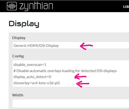

To get the LCD output on the HDMI monitor (in high resolution!) take the following steps (on all screens check advanced view):
  1. Make a backup of your current configuration (config only). Name it zynthian_config.LCD.zip

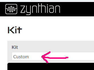

  2. Choose Custom kit (HARDWARE | Kit)

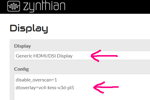

  1. Select generic HDMI display and add config parameter (dtoverlay=vc4-kms-v3d-pi5). Both are needed! (HARDWARE | Display)

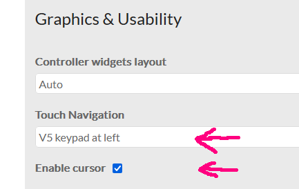

  1. Enable touch navigation so you can fully control the device with your mouse (INTERFACE | UI Options)
  1. Reboot the system, and look if it shows on the HDMI monitor. Your LCD screen and the buttons now stay dim.

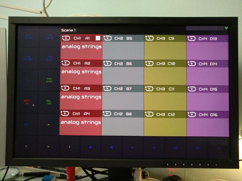

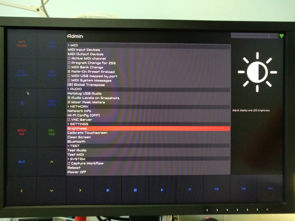

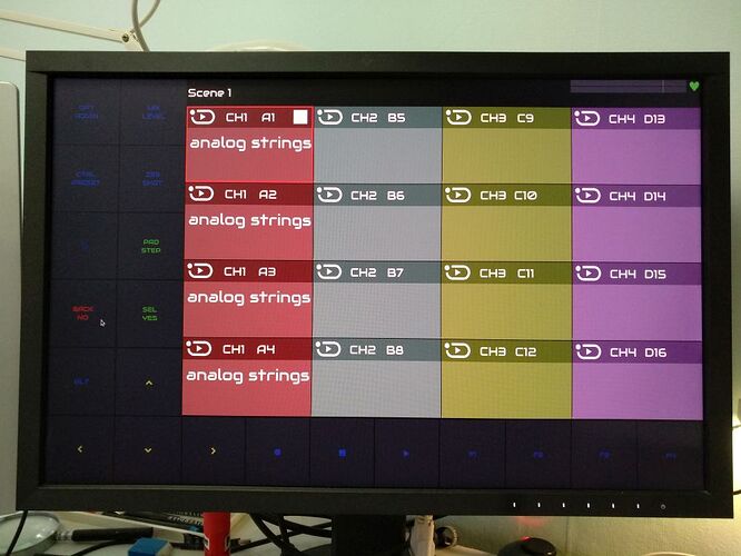

HDMI Examples:

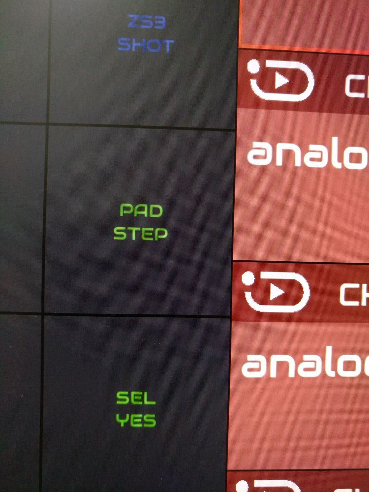

The image on the 24" monitor is razor sharp, if you see any fuzzyness that’s because of my shaking hands.
If you add a mouse to the Zynthian, you can fully control the device. The mouse functions as your finger. Short, bold and long press works the same. Buttons work the same. Sliders work the same.
If you use a wireless mouse, you can connect the zynth to your TV and control it from the couch :wink:
Only anomaly is when the power save timeout is reached, only the buttons dim, the “screen” stays lit.

Apparently I can no longer edit this topic (too old?)
I discovered that the above description no longer worked.
After a lot of trying I found the solution. By default, in config.txt there is a parameter that causes automatic detection of DSI displays. This overrules all other parameters.
Therefore it is necessary to disable this setting if you want to activate the HDMI display.
So add the following parameter: display_auto_detect=0.
After that the HDMI display works again.
