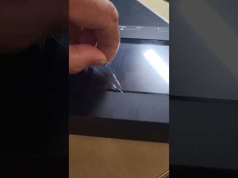

Fantastic video, thanks! I was waiting for that satisfying removal of the screen protector at the end of the video… but it never came! ![]()
