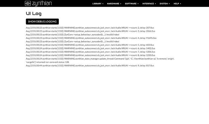

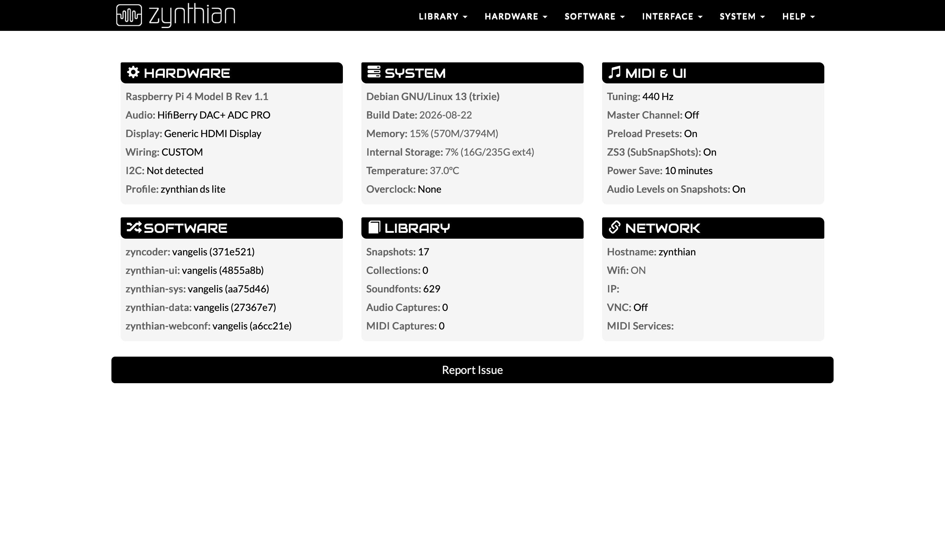

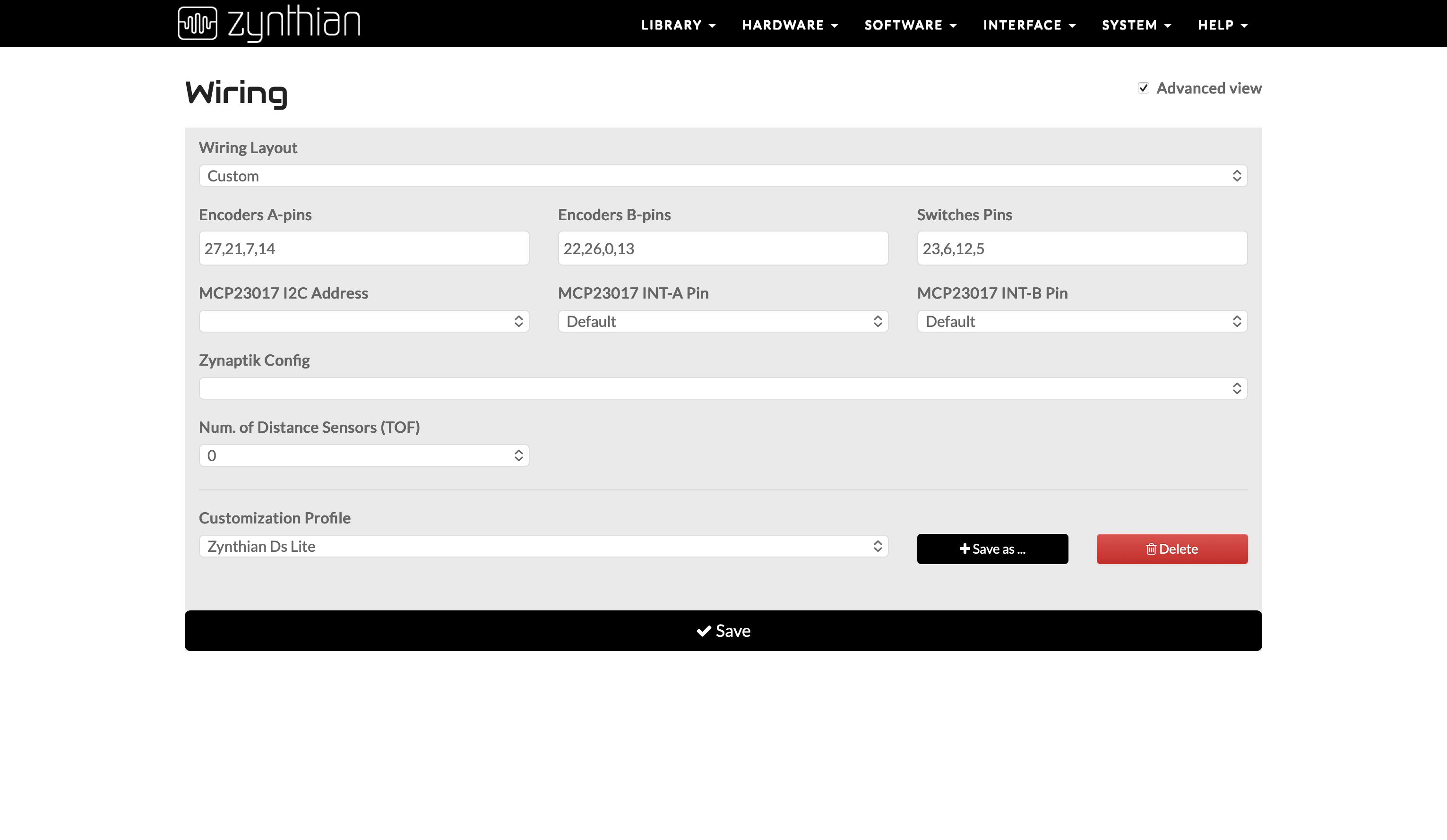

Hi folks,
I have a DYI Zynthian with GPIO direct wired encoders/switches(early version 4 knobs/switches) and serial midi on GPIO. I had all working great with ORAM image but with the new Vangelis image has an error on zyncoder initializing with my wiring config and the rotary encoders and switches stop working. The UI log error is “ZynCore->setup_behaviour_zyncoder(0, …): Invalid index!”.
I know the software has been developed for all the Zynthian kit hardware features but I was really hoping to keep my DYI Zynthian on Vengelis and test the new features further. The VNC UI works fine. Here is my config, wiring and error log.
Any help would be greatly appreciated.

What kind of problems do you have? I’ve got the DAC2 ADC Pro using the same overlay and would be interested if I have these as well.
I couldn’t get it to actually load and it failed like a traditional sulky audio device which bring a zynth to it’s knees. Your problem sounds considerably further than this in the process so I doubt it’s a factor, but it seemed wise to mention the coincidence. Apologies if I got your hopes up…
AS to your overall objective. I run a fair few home built, amused and abused zynths and I am transitioning them to the trixie build of Vangelis. They have all been running the previous Vangelis for some considerable time.
The zynthian-cajon7 & zynthian-rack8 are now both Trixie derivative. And seem to be behaving…
Issues seems more related to avialbaility of engines and the intricacies of lv2 configs… MiMiD is one of the chains I’m using so I’m watching those developments with some interest.
I have a couple of machines ( both Pi3’s ) which are pure encoder GIO machines so I will fire these up and see if they play nicely. I have had problems with previous GPIO encoder rigs upon PI kernel changes so we shall see… ( may not be within the next week…).
It’s worth plugging in a qwerty keyboard and seeing if everything behaves using that as a debug control source…
