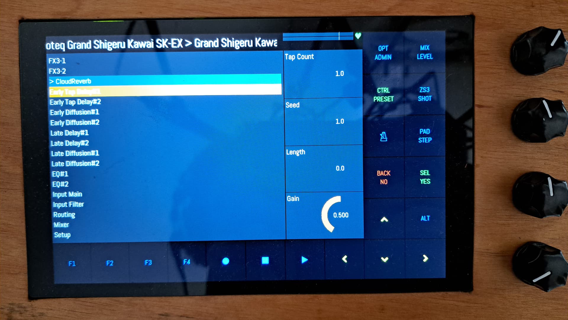

Here’s the binary, including binary, lv2-custom ttl and compiling output as .txt:
CloudReverb.zip (2.0 MB)
With the ttl I tried to replicate the native UI as good as possible.

  • Has no presets
  • Parameter values and so on seems fine.
  • No param groups by now (Edit: now there are)
  • Doesn’t spike cpu so much on Pi5
  • No notable heat rise

That’s great! Is there an easy way to get the presets which seem to be embedded in the code, but presumably selectable from the native UI over VNC to the zynthian system?
I mean, I’m aware how to save presets like here from the zynthian UI:
… but not how to prepare them to be embedded with the plugin repository to share.
