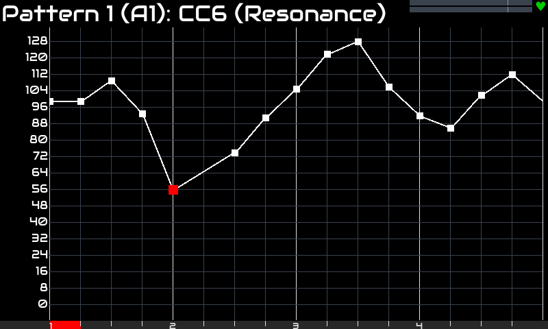

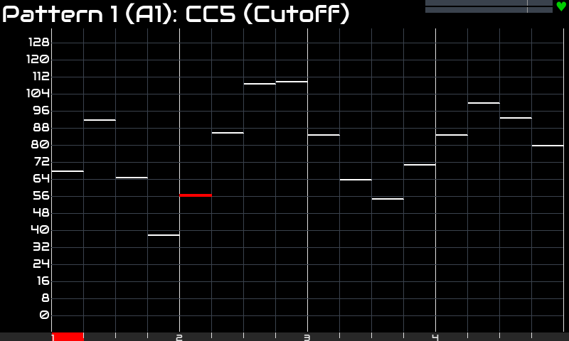

CC automation is being improved. We have implemented linear interpolation (1 point per clock). Of course you can disable interpolation and have discrete CC events. Also, “zynstep MIDI CC” has been added to the controller MIDI-learn options, so you can assign a CC number by hand or use normal MIDI learn. And MIDI CC capture works like a charm :wink:
I know, spline or bezier interpolation would be nice.

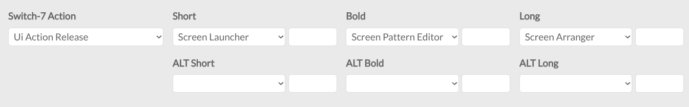

To enable PAD button to access launcher view:
  • In webconf, navigate to HARDWARE->Wiring.
  • Enable Advanced View.
  • Set Switch-7 Action to “UI Action Release”
  • Set Switch-7 Short to “Screen Launcher”
@jofemodo will you please add this to the default V5 wiring layout?
