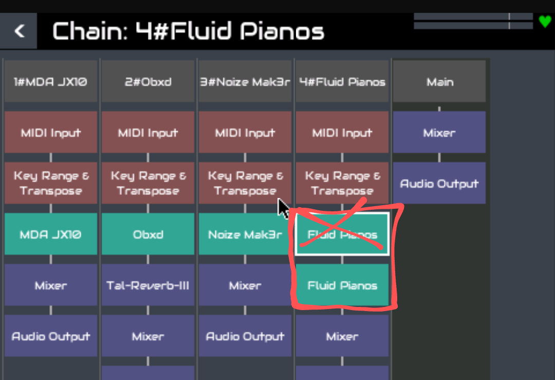

On very latest Vangelis on V4 kit, sometimes I end up with a double instrument in a chain. Probably due to clumsiness.
How can I remove just one of those? I see a replace but not a remove. And remove chain is too much :smiling_face_with_sunglasses:.
Best regards
That is a bug. Chain manager friend on no more than one synth engine. Please repost as a bug in issue tracker with as much info as you can about how to reproduce.

Logged, will update if I can reproduce.
