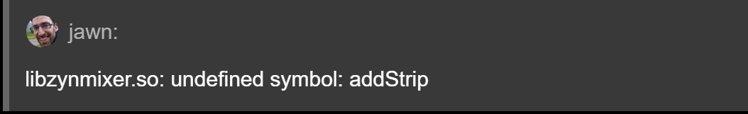

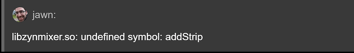

Updating resulted partial solution but still giving segfault without detailed error.
So I did two separate experiments, each with fresh SD card of latest stable oram on V4 kit:
  1. After first boot. Update to vangelis in 1 step. This gave error of missing dexed ttl definitions when testing dexed.
  2. After first boot, update to oram testing. This already gave a segfault. Manually power off, on successfully. Can add dexed, surge chains. Then update to vangelis, this results in boot screen error Software and following UI log:
Jan 10 17:12:32 zynthian startx[1183]: AttributeError: /zynthian/zynthian-ui/zynlibs/zynmixer/build/libzynmixer.so: undefined symbol: addStrip
Jan 10 17:12:32 zynthian startx[1183]: libzynaudioplayer exiting… done!
Jan 10 17:12:32 zynthian startx[874]: *******************
Jan 10 17:12:32 zynthian startx[874]: EXIT STATUS => 1

Jan 10 17:13:23 zynthian startx[1363]: Loaded libzynaudioplayer using libsndfile-1.2.0
Jan 10 17:13:24 zynthian startx[1363]: Traceback (most recent call last):
Jan 10 17:13:24 zynthian startx[1363]: File “/zynthian/zynthian-ui/./zynthian_main.py”, line 47, in
Jan 10 17:13:24 zynthian startx[1363]: zynthian_gui_config.zyngui = zyngui = zynthian_gui()
Jan 10 17:13:24 zynthian startx[1363]: ^^^^^^^^^^^^^^
Jan 10 17:13:24 zynthian startx[1363]: File “/zynthian/zynthian-ui/zyngui/zynthian_gui.py”, line 157, in _init_
Jan 10 17:13:24 zynthian startx[1363]: self.state_manager = zynthian_state_manager.zynthian_state_manager()
Jan 10 17:13:24 zynthian startx[1363]: ^^^^^^^^^^^^^^^^^^^^^^^^^^^^^^^^^^^^^^^^^^^^^^^
Jan 10 17:13:24 zynthian startx[1363]: File “/zynthian/zynthian-ui/zyngine/zynthian_state_manager.py”, line 154, in _init_
Jan 10 17:13:24 zynthian startx[1363]: self.zynmixer_chan = zynmixer.ZynMixer() # zynmixer used for channel strips
Jan 10 17:13:24 zynthian startx[1363]: File “/zynthian/zynthian-ui/zynlibs/zynmixer/zynmixer.py”, line 60, in _init_
Jan 10 17:13:24 zynthian startx[1363]: self.lib_zynmixer.addStrip.restype = ctypes.c_int8
Jan 10 17:13:24 zynthian startx[1363]: File “/usr/lib/python3.11/ctypes/_init_.py”, line 389, in _getattr_
Jan 10 17:13:24 zynthian startx[1363]: func = self._getitem_(name)
Jan 10 17:13:24 zynthian startx[1363]: File “/usr/lib/python3.11/ctypes/_init_.py”, line 394, in _getitem_
Jan 10 17:13:24 zynthian startx[1363]: func = self._FuncPtr((name_or_ordinal, self))
Jan 10 17:13:24 zynthian startx[1363]: AttributeError: /zynthian/zynthian-ui/zynlibs/zynmixer/build/libzynmixer.so: undefined symbol: addStrip
Jan 10 17:13:24 zynthian startx[1363]: libzynaudioplayer exiting… done!
Jan 10 17:13:24 zynthian startx[874]: *******************
Jan 10 17:13:24 zynthian startx[874]: EXIT STATUS => 1

In the second experiment, power off / on is no workaround
If useful, I could test the fresh update path without restoring last snapshops
How did you update?
This error shows that the mixer library does not have the addStrip function which it should if updated and compiled (which is done by the normal update process).
Ik have to laugh (being very impressed!!)… How incredible unbelievable that you saw that @riban !!
Update, changed version via webconf. Triggered update from Zynthian touch screen, admin menu.
Strange! It very much looks like zynlibmixer has not been recompiled with the vangelis version which adds this function that is not in the oram version.

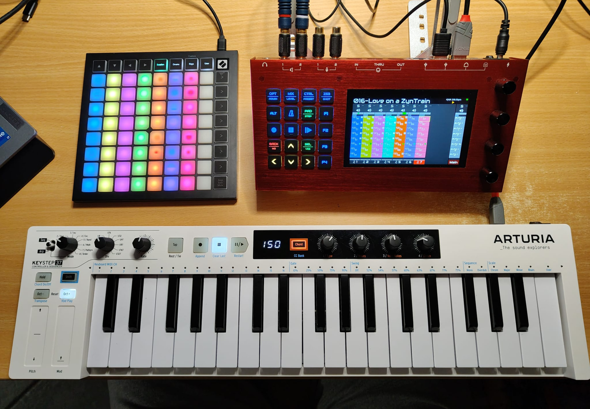

Yes, Launchpad Mini Mk3 works great! :smiling_face_with_sunglasses:

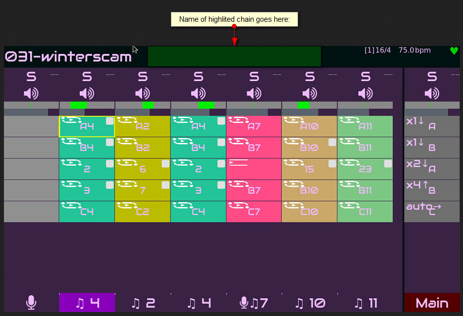

When in launcher view, i would like the name of the active/highlited chain after the title of the snapshot:
Should i put something like this directly to the issue tracker?
