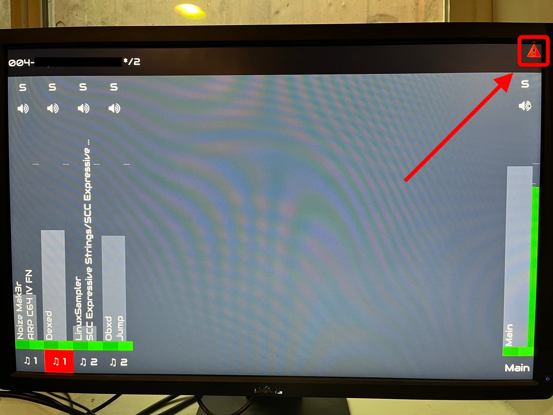

I created a 4-chain snapshot that is I think fairly simple, but several times now it has caused my Zynthian to go “full-tilt,” where it does not respond to any keyboard input. It instead displays a red triangle with an exclamation point in the middle, per this screenshot:
My first question is, is there anything I can do if this happens in performance to immediately get the Zynthian to respond again to the keyboard? Rebooting seems to be the only option when this happens, and that’s at least 30 seconds, which isn’t workable in a performance.
My second question is, is it possible to get diagnostic information from the Zynthian that would tell me why this is happening? I sense it is because of the LinuxSampler SCC Expressive Strings/SCC Expressive patch on the 3rd chain in this screenshot.

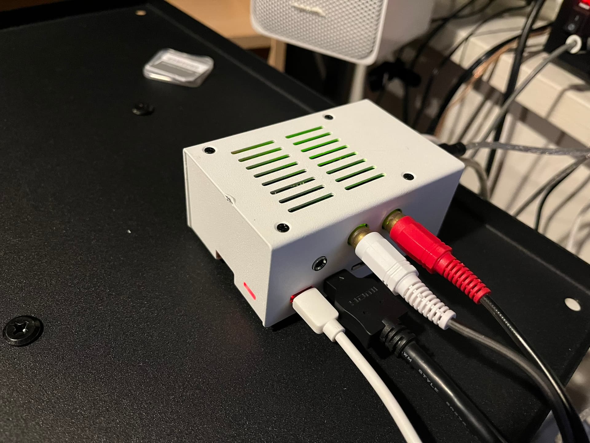

I would not expect LinuxSampler to trigger xruns on a RPi4. What is your heat dissipation arrangement? Do you have a heatsink correctly attached to the SoC? Do you have a clear path for which heat to dissipate from the heatsink to the external environment? Is the device sitting in free space and not enclosed with restriction to air flow? Are you working in a fridge or oven or somewhere inbetween? :wink:
What is the power supplier? Is it an official Raspberry Pi PSU? Does it have an inline switch?
I’ve attached a photo:
It has a HiFiBerry+ sitting atop it, so I don’t think there is any heatsink. I tried taking the case apart, but I was having trouble prying the HiFiBerry away from the RPi4 so decided to abort that.
The power supply is 5v 3a. I don’t know if it is an official RPi PSU, but I’m fairly certain it was one recommended on the Zynthian board.
I don’t tend to work in fridges or ovens. I keep it in free space, though as you can see in the picture it is enclosed with vents.
