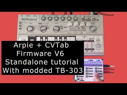

And, while we’re on the subject of arpeggiators, here’s an Arduino-based open source hardware and software arpeggiator that I found. It’s not an answer to any question here, I just thought some of the ideas might be interesting:
Their intro from User guide:
Arpie is a MIDI arpeggiator. In its most basic application, you connect it between a MIDI controller keyboard and a MIDI controlled synthesizer and it arpeggiates chords that are held on the keyboard – meaning that it converts them into sequences of notes. There is a lot more to it than that but it’s a good basic description. Despite its simple construction and appearance, Arpie is fully featured with various chord arpeggiation, tempo synchronisation and standalone features to enable it to be used creatively with or without an attached keyboard. Arpie is based around open-source software and hardware. The Arduino-based firmware allows maximum hackability and the hardware is designed for easy DIY assembly and customisation.
Video demo:
User manual:
Quick Reference:
thanks.
It looks cool but as is, it’s quiet expensive regarding the hardware configuration. Thé good news: it’s open source.
