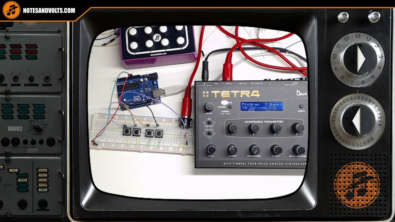

The USB HID (Human Interface Device) library is built into the Arduino IDE. It can emulate USB devices like keyboards, mice or USB MIDI.
You must use a biard with the ATmega32U4 processor, which handles USB on board, unlike most other Arduinos, the Leonardo or small inexpensive Pro Micros are examples. This makes for a cleaner implementation than bit banged code on a common arduino.
Adafruit has some ATmega32U4, the powerful 32 bit teensy board family has a similar USB library.
Sorry I don’t have an exact design for your solution.
Here’s a video tutorial using the mentioned Arduino models,
The page has a few links, including this library
