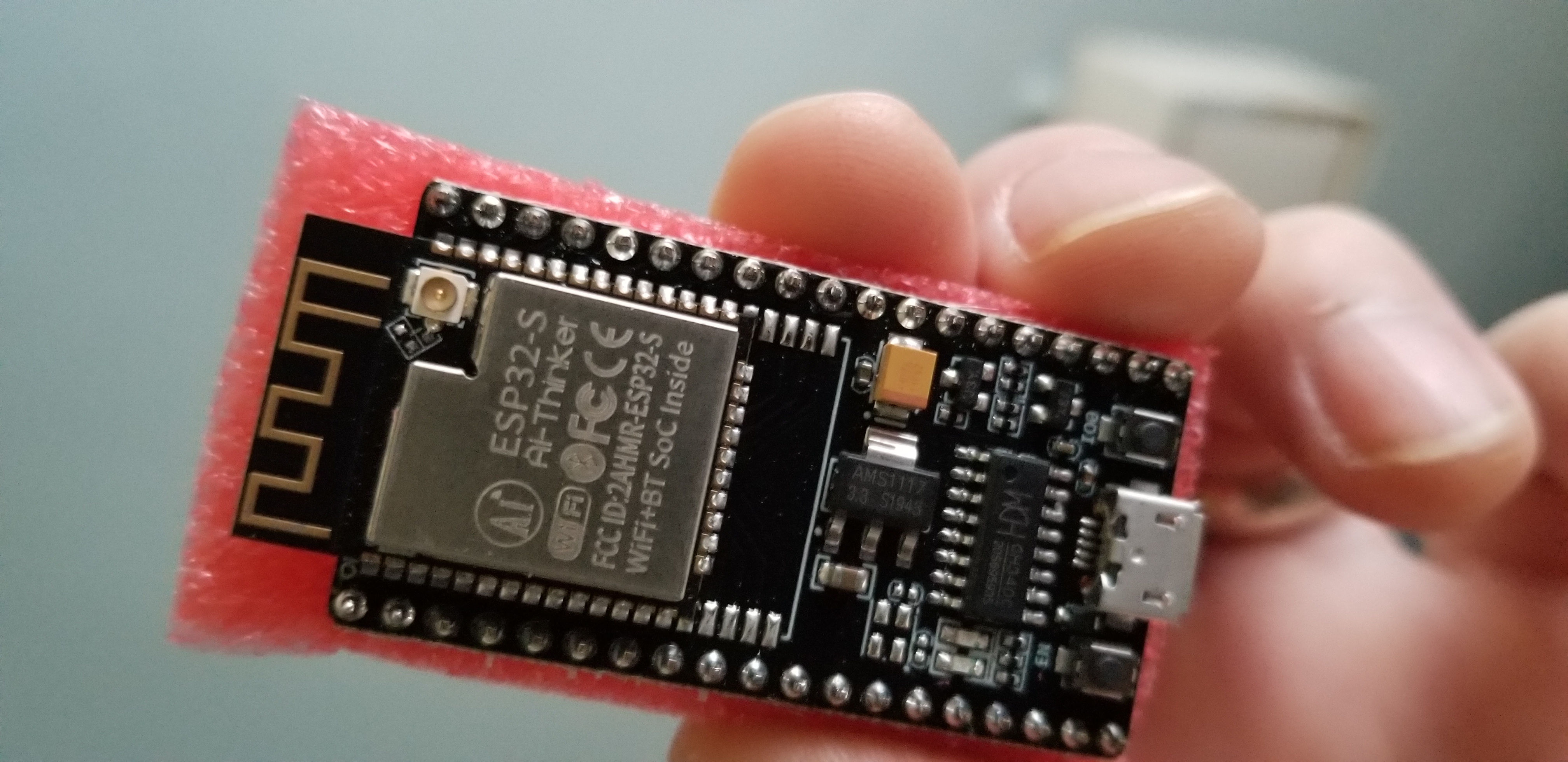

Any news on the esp32 version? Should I just use this for something else?

There was a guy who had a sound generating port working, hut I haven’t heard from him in a long time. He had “only” played MIDI files somehow… and he said that he had a lower polyphony… something around 8 simultaneous notes.
MicroDexed without effects has 16, with effects 12 and with dual mode (two engines simultaniously) about 10-12 (on a T3.6, perhaps 2*16 with FX on a T_4.0).
