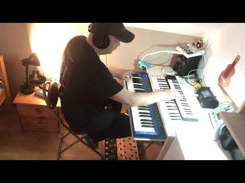

I’m here with you for over three years. I know almost nothing about coding but over the years I’m trying to live with my music using zynthian. lately i’m plaing bass in my cover band along with using self made bass pedal attaching to zynthian. But now while everybody doing this home made solo shows I have tried too
. This is my live electron music fragment from my bedroom. All hands and foots playing is zynthian. The rest is Yamaha qy70. Thanks you all. Adam.

Thanks for your kindly words.
This set is my idea for non-computer one-man electronic music - live.
Loops and percusions are made with old fantastic yamaha qy70 sequencer controling by foot self-made sysex controler (arduino).
Another one octave foot controler is arduino-micro based and controling one of the Zynthian midi channels along with standard midi keyboards on others channels.
There is a snapshot with several sounds:
1#JV/Obxd>KVR_Leads/Bermuda_Lead_IW
2#ZY>Strings/Strings Pad6
3#ZY>Arpeggios/Sequence2
4#ZY>net-wisdom/Prophet horn 1
5#ZY>net-wisdom/Vangelis Saw - A
7#ZY>Pads/Resonance Pad1
11#FS>FluidR3 GS/Wind Chimes
12#ZY>net-wisdom/Rising bleeps
13#ZY>Noises/Noise2
16#JV/ZynEcho>None/Echo 3
After all Zynthian is FANTASTIC!! Thanx!!

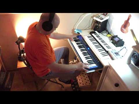

I don’t have enough courage to bother You All by my music, but I still will continue to publish my bedroom lockdown live Zynthian performaces on my YouTube channel every Thursday for a couple next weeks. So Please feel free to look at it If you like. The next one - tomorrow evening.
Thanks for Zynthian Community and Your attention.
