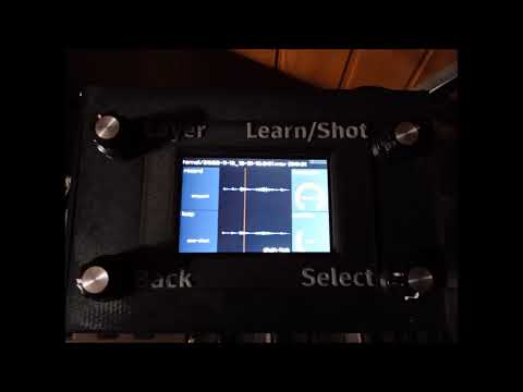

I took the liberty of publishing a video that refers to the Zynthian’s site… I am so satisfied with this … creature… that I MUST do something to make it known… I discovered it by looking for the project for the Dexed (which I made), but this… this is a masterpiece…
Excellent. Thank you.
Very nice!
Heeey, thanks for posting this - but you posted the preview version of this video. In the official one, I added one or two more things (for example the arranger).
In my older videos I had some inaccurancies / outdated information, so I tried to avoid that this time, but the rule of thumb in Linux is there’s always someone who knows better, so my apologies in advance for anything I said or didn’t say. ![]()
ZYNTHIAN is an enormous achievement. Definitely one of the best things to emerge from the RasPi/Linux community.
edited/reposted @mr_floydst . Let me know if its still the wrong one
