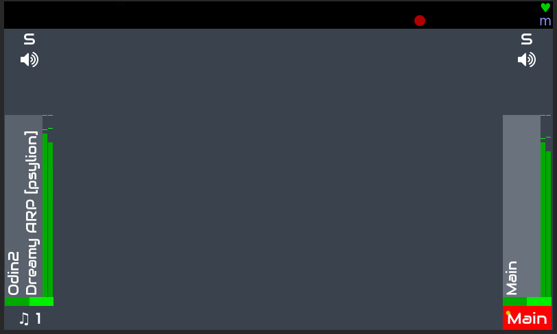

Does the red circle appear and disappear as described?
I can’t see any “Start Audio Recording” and “Stop Audio Recording” option. Pushing the record button it seems it starts recording as i see the red circle but in the end nothing is recorded.

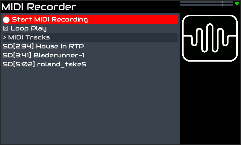

In the Midi Recorder window i habe the “Start midi recording” option and it seems to work, but again it won’t record anything.
MIDI recordings are only made if there is some MIDI received during the recording. So if you start MIDI recording then stop it again before sending MIDI to the zynthian, there will be no resulting SMF.
Audio recording should be recorded whilst the red circle displays. How are you checking for audio recordings?

Yes, of course i play something on my keyboard controller while trying to record. I can ear the sound and i see the meter moving in the Mixer window.

This seems to be something specific to your workflow. Audio and MIDI recording has been working fine in stable, staging and testing without anyone reporting any issues. Will you please describe each step you take to make a recording and check whether it has suceeded?
