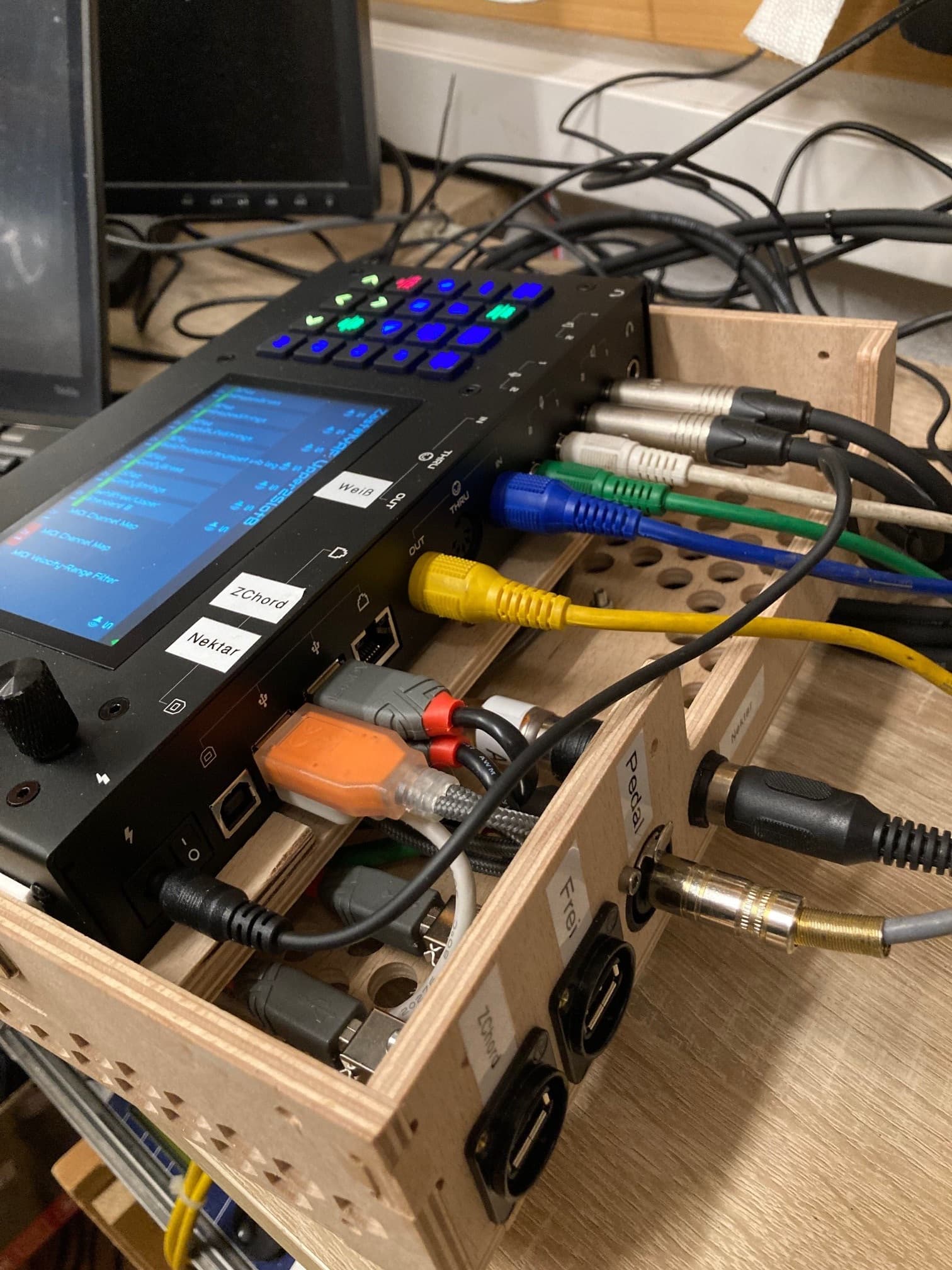

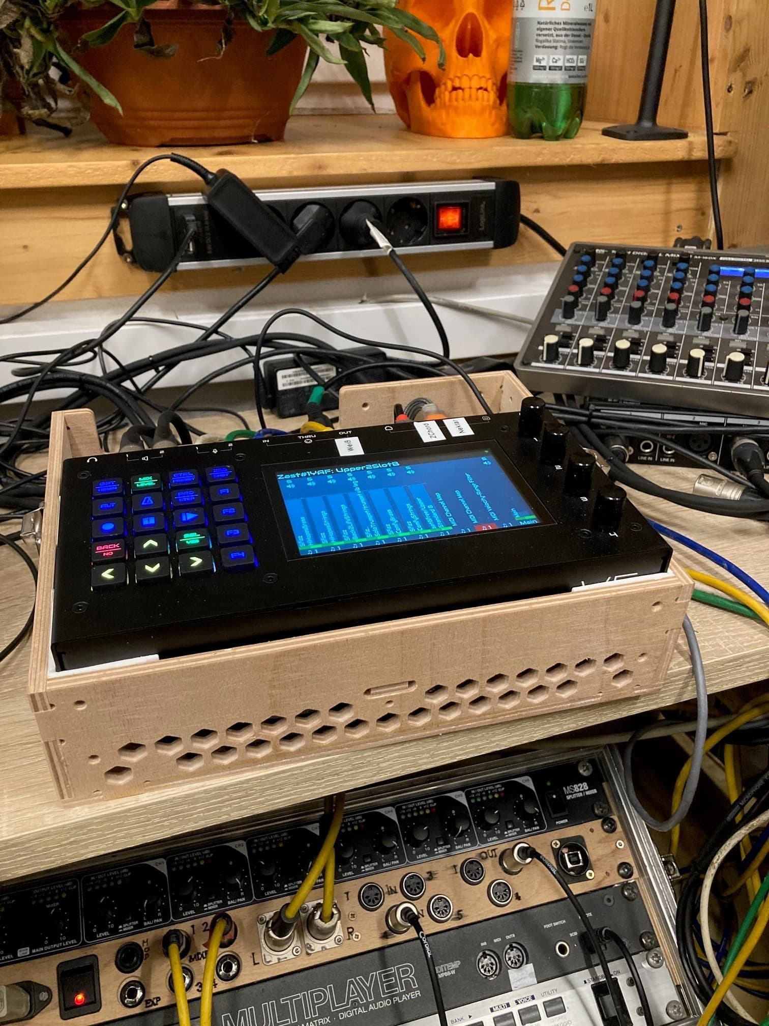

I built a hard transport case for my V5.1 Zynthian
Looks a bit like beauty case, but it“s much more fun :grin:

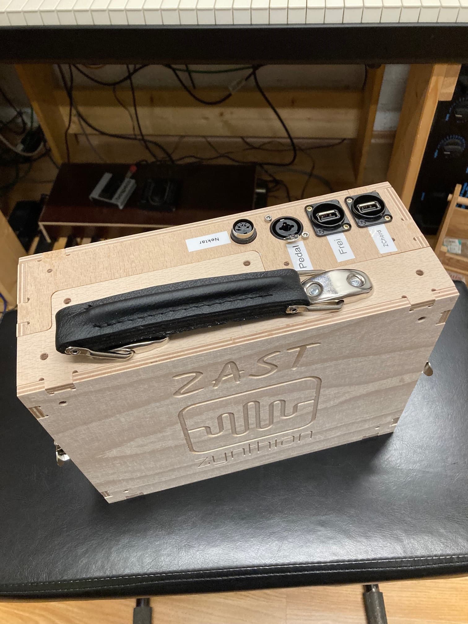

It“s designed for gigging and when I go to the rehearsal room of my Band
All USB Ports are connected permanent so I don“t need to plug and unplug each time when changing locations. I see it as critical for USB connectors to be plugged frequently.
They are directly soldered to the Raspberry, so if one breaks, the whole Rasp is damaged.
Audio and Midi jacks are robust enough. Thanks to Zynthian Mainboard Designers :ok_hand:

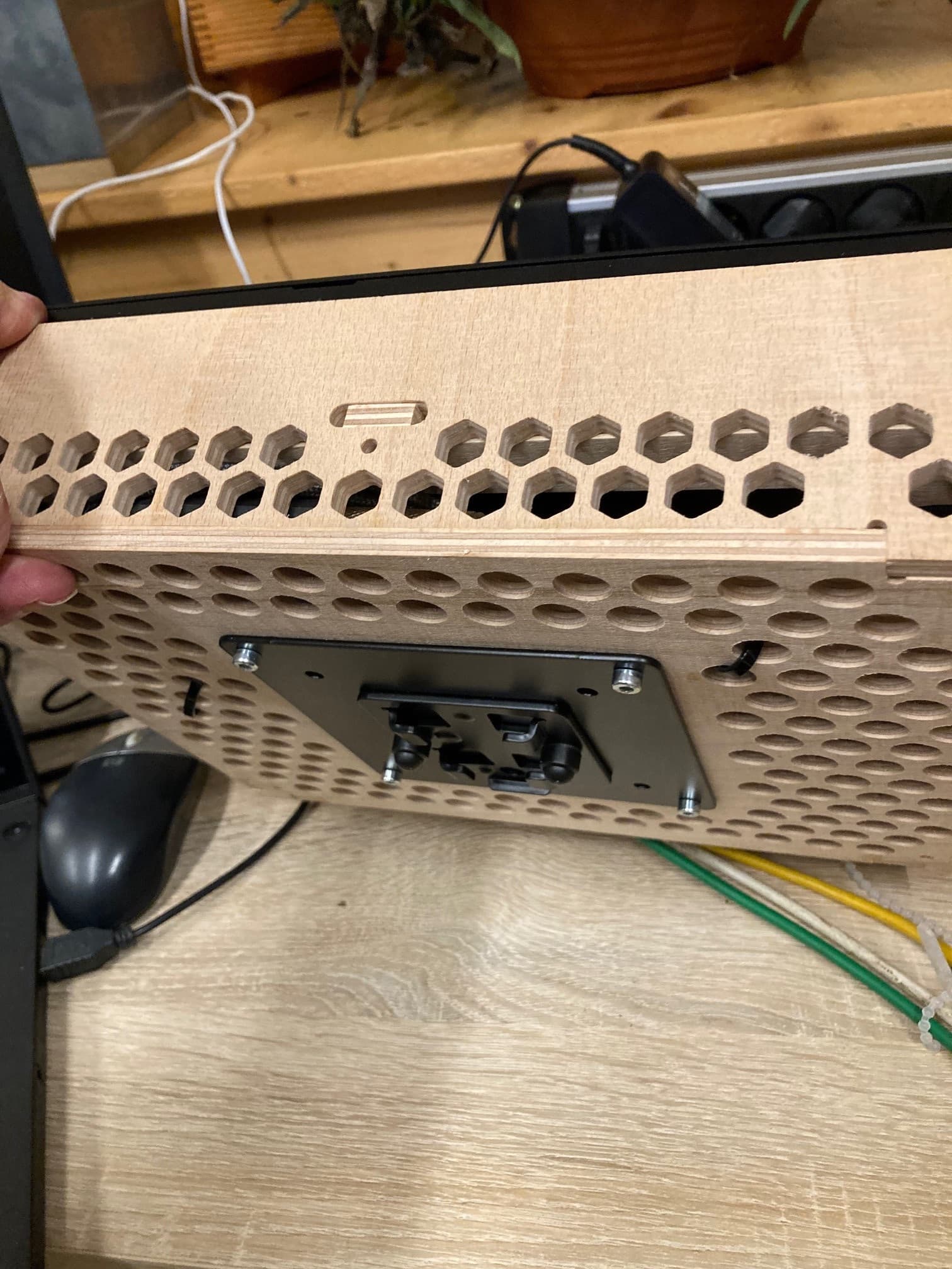

The Housing is vented well on all sides an also from the bottom to maintain good cooling of the Zynthians Bottom.
There is also a double floor to keep permanent cabling inside the box.
And a Vesa - Port on the bottom with a quick lock device to place it on a microphone or any other stand.
Hope You like it :grinning:

Where did you buy the hexagonal drill?
Wow - Beautiful!
And where did you get those chassis mount USB extenders - manufacturer and part number, please?
It“s not a drill of course :wink:
In fact I did all the wooden parts with my home brew milling machine
beech plywood 6mm
This is a ā€œNeutrik NAUSB-W-Bā€
I bought it at Thomann (Germany)
It has a USB ā€œAā€ on one side and USB ā€œBā€ on the other side. As the Insert is reversible you can decide which one is on the outer side of the chassis.

I use the double USB surface mounts. The cables tend to need carefully coiling and you do get physical interference problems with devices of one sort and another
It looks magnificent and very carefully considered.
Anything you would alter in retrospect?
Looks usable, but I“m also happy with my solution.
Indeed!
Is it making impressive sounds…?
right now It“s only a replacement for my Yamaha Motif Rack, I do mainly Strings and some lead synth sounds. Currently I sampled everything I need from my Motif and use these sounds on the Zynthian (Sfizz) Sample Player.
I didn“t dive into synth engines so far.
Look forward to do this in the future.
Also use Audio Mixer and some MIDI routing.

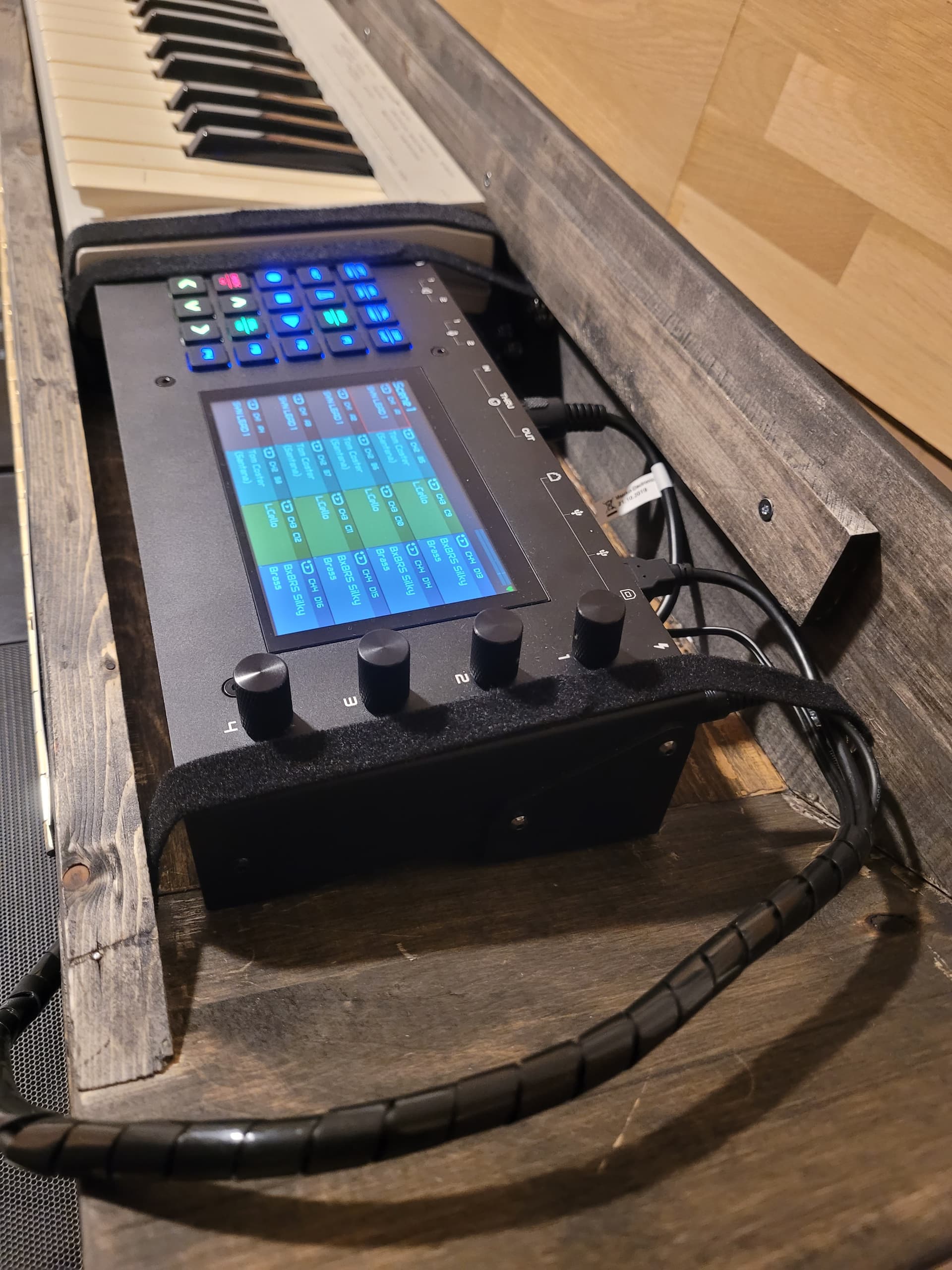

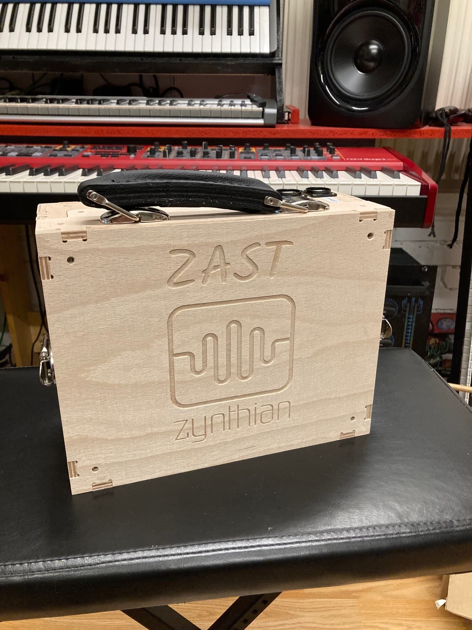

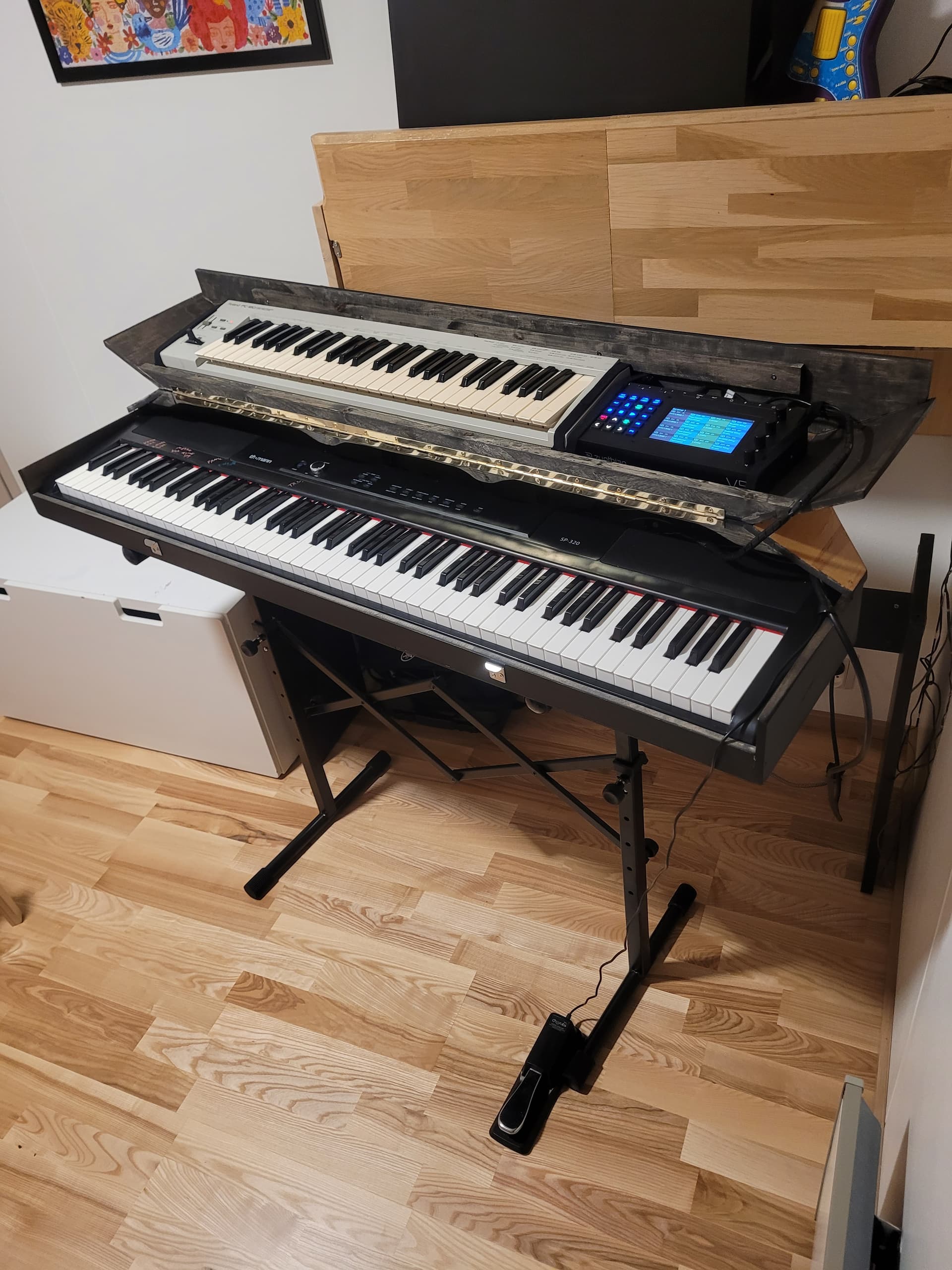

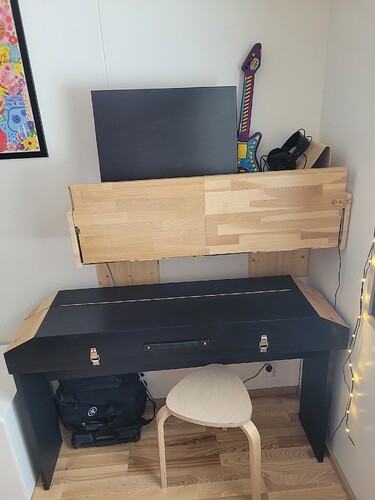

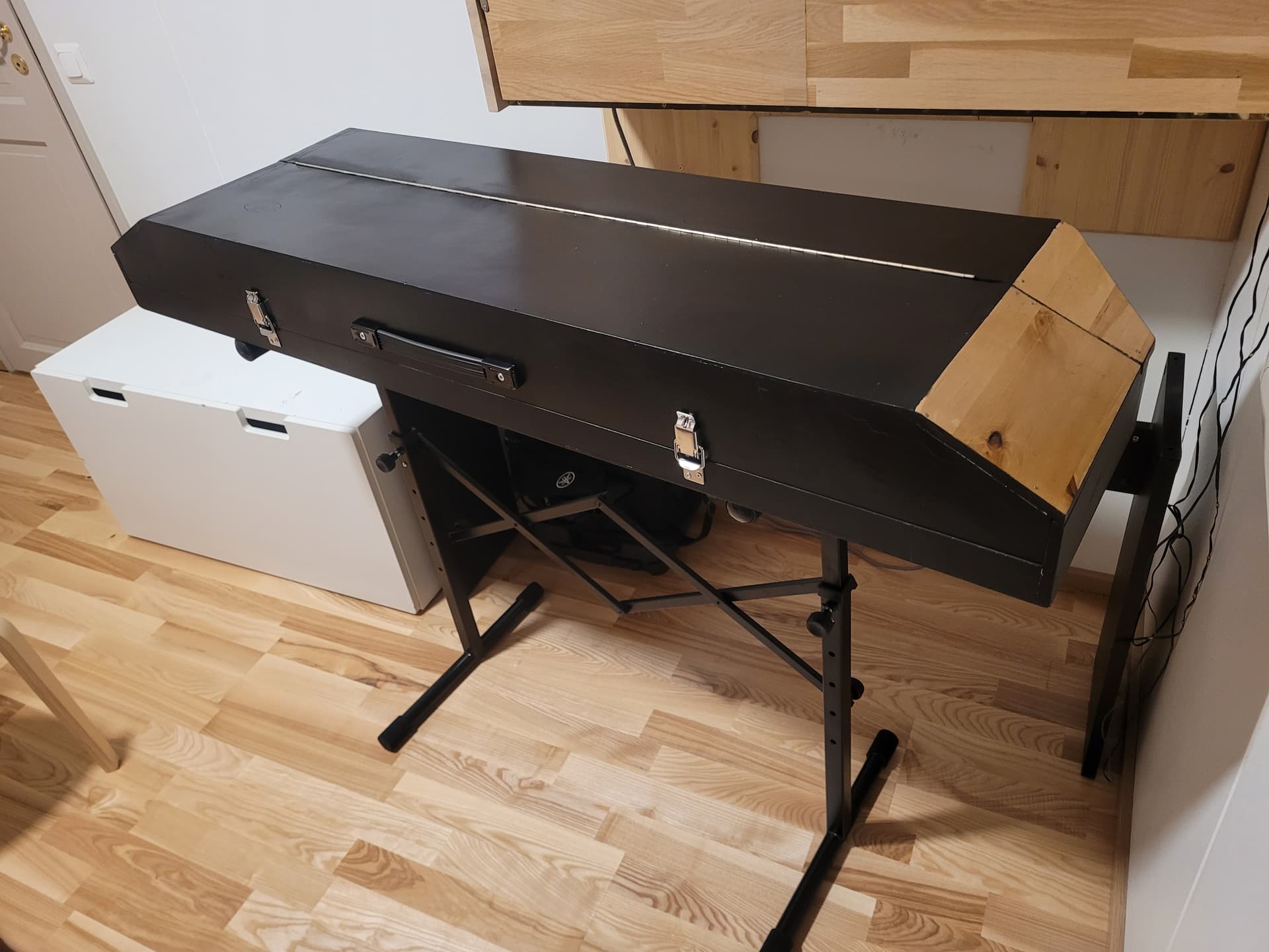

I wanted to reduce the unplugging and replugging wires when transferring my zynthian to band rehearsals or gigs and decided to go for a custom hard case.
It it built of 10mm Scandinavian birch planks and 4mm recycled plywood from back of some shelf. Aim was to keep it light. On top of that, I wanted it to fit diagonally in the trunk of my car, so some corners were cut where possible :smile:
Dimension needed to be quite careful to allow zynthian and smaller keyboard fit on the lid. They are kept in place with velcro cable ties.
Not yet real gigging experience as build is fresh still, but it lives quite happily under my desktop.
