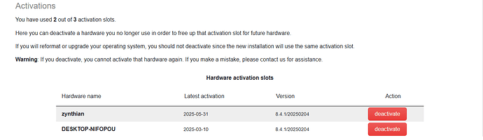

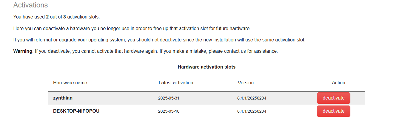

I haven’t checked back through the whole thread but did you previously deactivate the license from within the Modartt Licence information page.
There is a warning that you can’t reactivate on the same device.
Ah, I will try that. I didn’t think it was successful.
Yeah. Looked on Modartt. I am only using the license for my laptop, not the Zynthian.

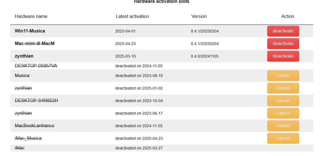

Remember that unregistering a device will render that device unavailable to be used for Pianoteq, i.e. you cannot unregister then re-register. This is a protection that Modartt use to avoid abuse of their (generous) licensing, i.e. you cannot move your license between machines at will to extend beyond the 3 machines per license.
Exactly as @riban says. I accidentally deactivated the license on my iMac and had to write to Moddart who in a few hours deleted the iMac from my computer list. Then I re-registered the iMac and everything was fine.
As you can see in this period I transferred the license to many computers and to the minimal Zynthian that I had built… Now I hope I will not have to do it again and that I will be fine for a long time… In doing these operations I made a mistake and I had to write to Moddart who, without any problem, reset all the changes and I was able to fix things.
Interesting. How can I tell if that’s what’s happening. When I look on the Modartt site it just says I have used 1 of 3 licenses (the one I used for my laptop). Can I view a history of devices that can’t be re-registered?
I do not think any registration went through on your pi, or it would already show as either activated or deactivated.

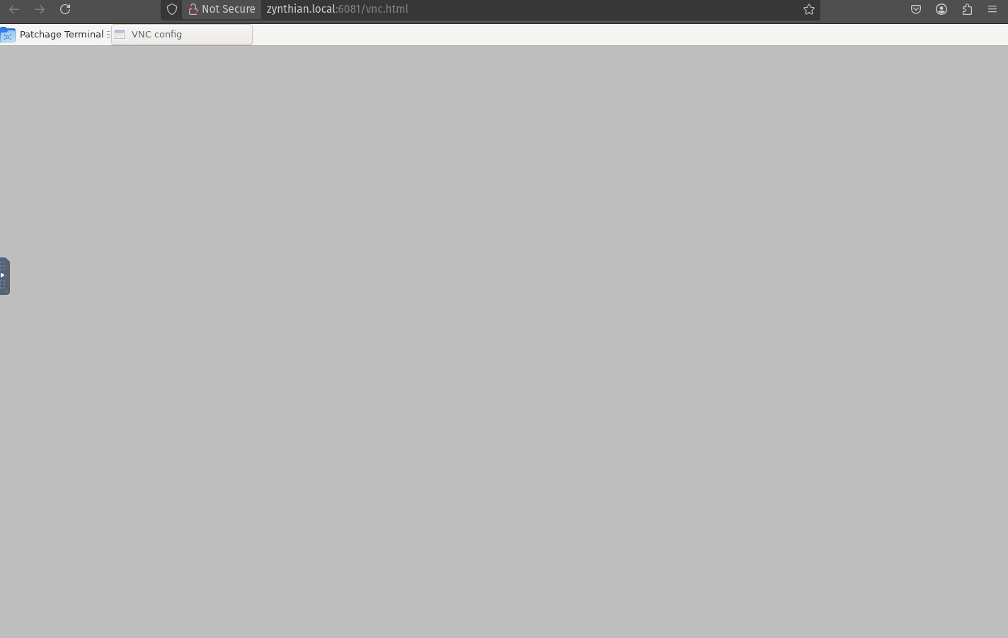

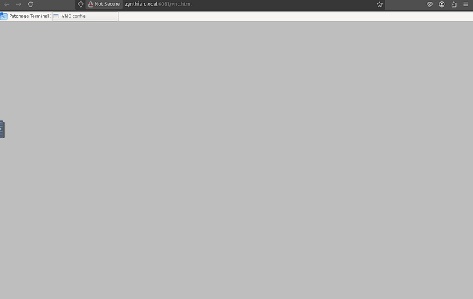

Have you tried vnc (engines) from the webconf?
Or to run the pianoteq binary when logged in via ssh -X?
Hi @wmnelis !
Please, tell me your shipping address by private message and i will send you a good SD-card with the latest version and Pianoteq Standard installed, so you only need to intro your license number.
All the best!
@jofemodo Thank you, that is a generous offer. I think just an image of the card would be sufficient.
@niels How do I start up the Pianoteq application via VNC? It looks like the VNC desktop doesn’t have anything on it but terminal and patchage
