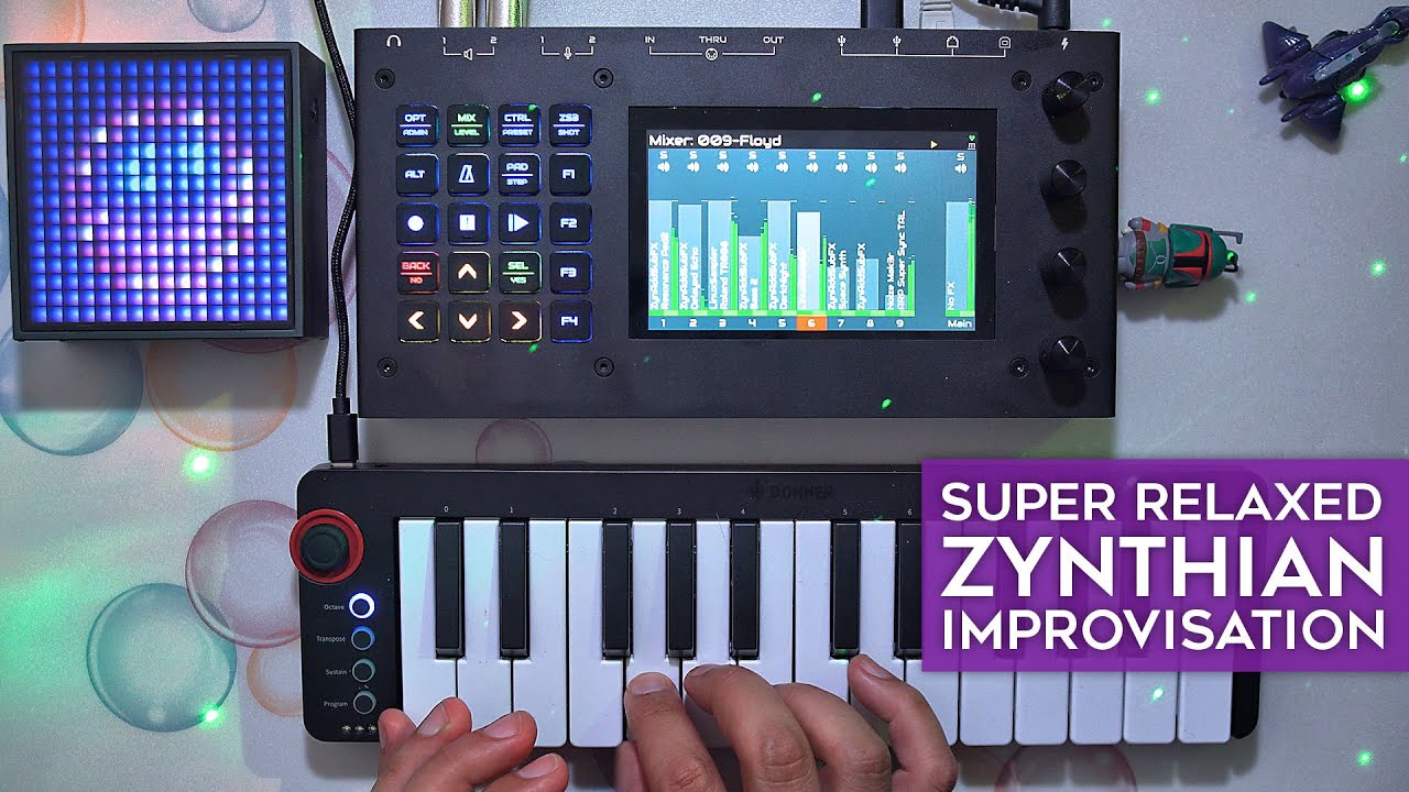

Nice improvisation by Floyd Steinberg (@mr_floydst) on V5.
This is for me a natural evolution of using Zynthian, a mix of sequencer-based tracks and a bit of playing with a keyboard controller.
Oh, thanks for sharing this here! :wink:
Hi @Nicolaz !!
Check you private messages! I’m waiting for your answer.
Cheers!
Hello @mr_floydst ,
you’re welcome. I am a subscriber to your YouTube channel, so I discovered the V5 video quite early. It’s a very nice example of working with Zynthian,I think the development core is certainly pleased by your show. And laiks belongs to you.
I have to agree with @Nicolaz that this is probably the natural evolution of how to work with Zynthian, see his video where plays with the help of Launchpad. Latest musical "effort" 🧐 .. Thanks Zynthian - #61 by jofemodo
Your examples show how @riban’s stubbornness paid off during development. When I first saw the sequencer in the working version, I didn’t really understand what it would be for :slight_smile: Well, I’m not the brightest. (the sharpest pencil in the pencil case, as we say). So I also have to thank @riban.
