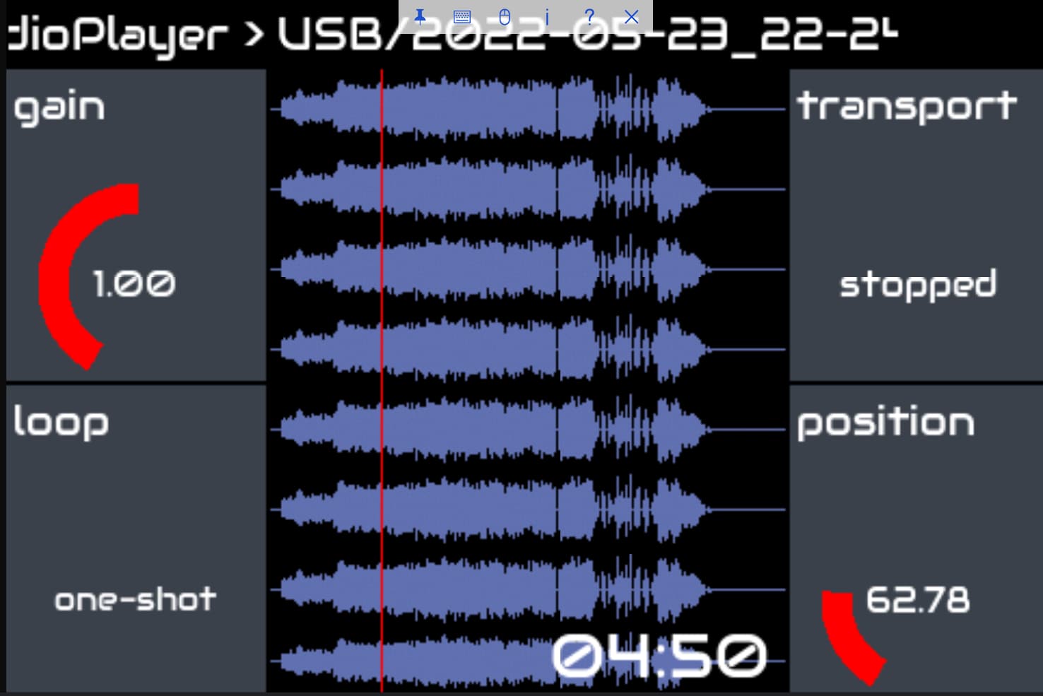

Opened the new recording in one of the players - 8 channels of audio drawn in waveform
Recording multi-track file started to distort and warble after 107s - we use an off-the-shelf recorder which may have limitations - I will investigate what optimisation we can do
All channels were mono - need to check my test scenario, routing, etc.
Club members said they want different colour waveforms which is not a feature of the library - I will submit a feature request upstream
