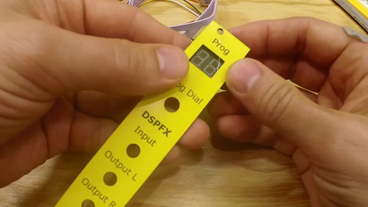

Guy Hacks up a working 100 preset Reverb, etc. Board to fit Eurorack
This DSP based effect assembly is available on the Chinese surplus outlets, price has gone up since he built his, now costing about $18 delivered.
Reverb Module Reverberation Mixer 100 Kinds Effects Board (Many sellers at Aliexpress)
$11.35 + $5.78 shipping . . . $17.24 Free Shipping
He describes it in the video as:
“100 different dsp effects, ranging from reverb and delay to chorus, flanger, phaser, pitch shift etc.”
(Wire cutters applied to the PCB looks like a failed magic trick moment…)
Resource Links on the Youtube page.
Examining board images, for chip part numbers, it seems to use:
Cirrus Logic CS4220-KSZ DSP
Wavefront AL3201BG Codec
Atmega8A 32 pin Arduino class 8 bit microprocessor
